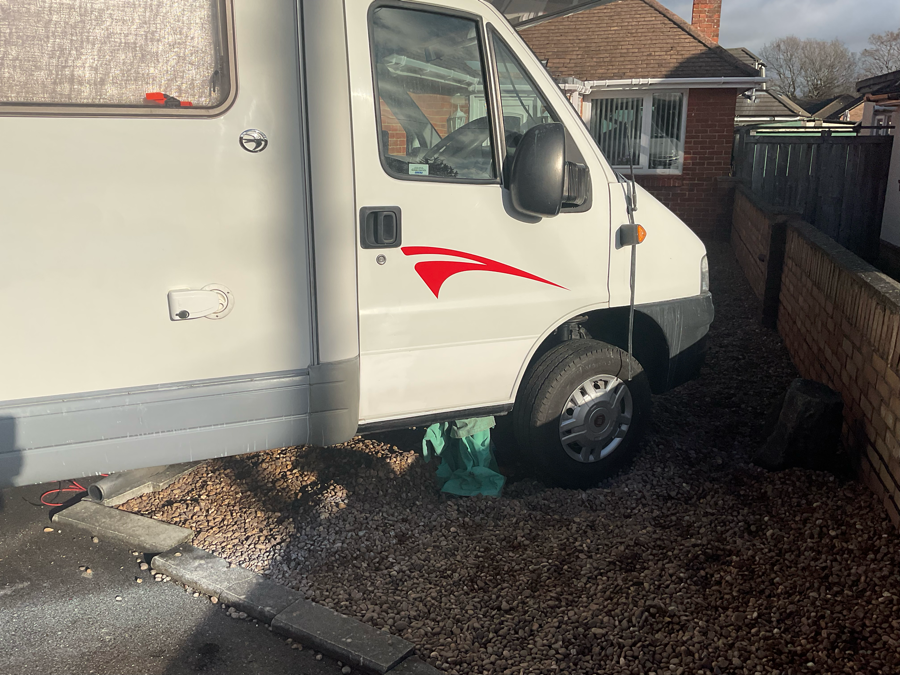

Today all the old graphics are now gone the new ones on and another stupid item that I wanted to do was to put on a security latch on the hab door.
I have already done both cab doors and this was the last one to do . I wanted it done for when we’re off grid as an added security method.
however the inside of the door was hard plastic with a foam core and very thin alloy skin.
so there was not much to screw into and decided I would bolt it right through with an alloy plate both sides.
there is a full size fly screen that fits to the inside of the door and the sash lock just fitted.
and that’s what I did.
then fashioned a side reflector to cover the nuts and alloy plate.
turned out ok. For an old Moho.
now have to decide wether to add some more side reflectors same level down the sides. In fact both sides.
the latch is a sash lock latch and is exactly like the cab ones. One key fits all.
I think it was about £6 on eBay a lot cheaper but the same ones as advertised for motorhome cab locks.

That’s a nice job. Amazing what you can hide with a reflector. Will certainly make you feel more secure while wild camping. 👍
That’s the idea its the weakest link in safety.
should feel a lot better about it now.
and the list of to do has another few item wiped off today.
