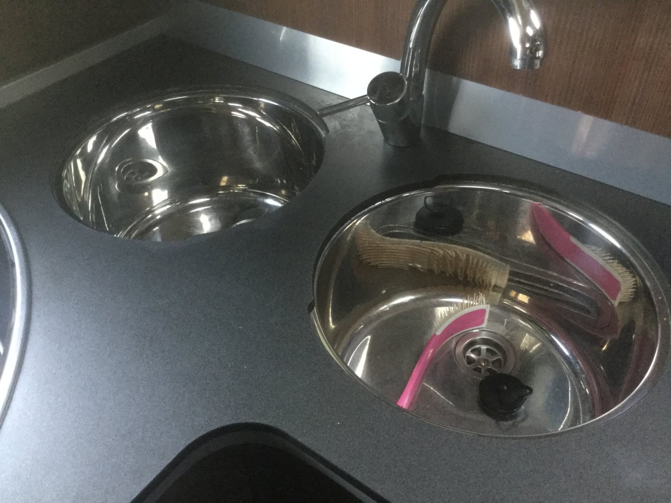

I agree, the location above the fridge is a red herring. There is plenty of room - see the image I posted above of the underside of our sink. We even have room for egg cups below it. :)
I think that’s very easy to say when you have shown your sink does not have a fridge underneath it that pipe would have to go behind the fridge down to the floor if there is enough room? And in my experience there will be very little space so the pipe could be crushed (poor design IMHO)?
