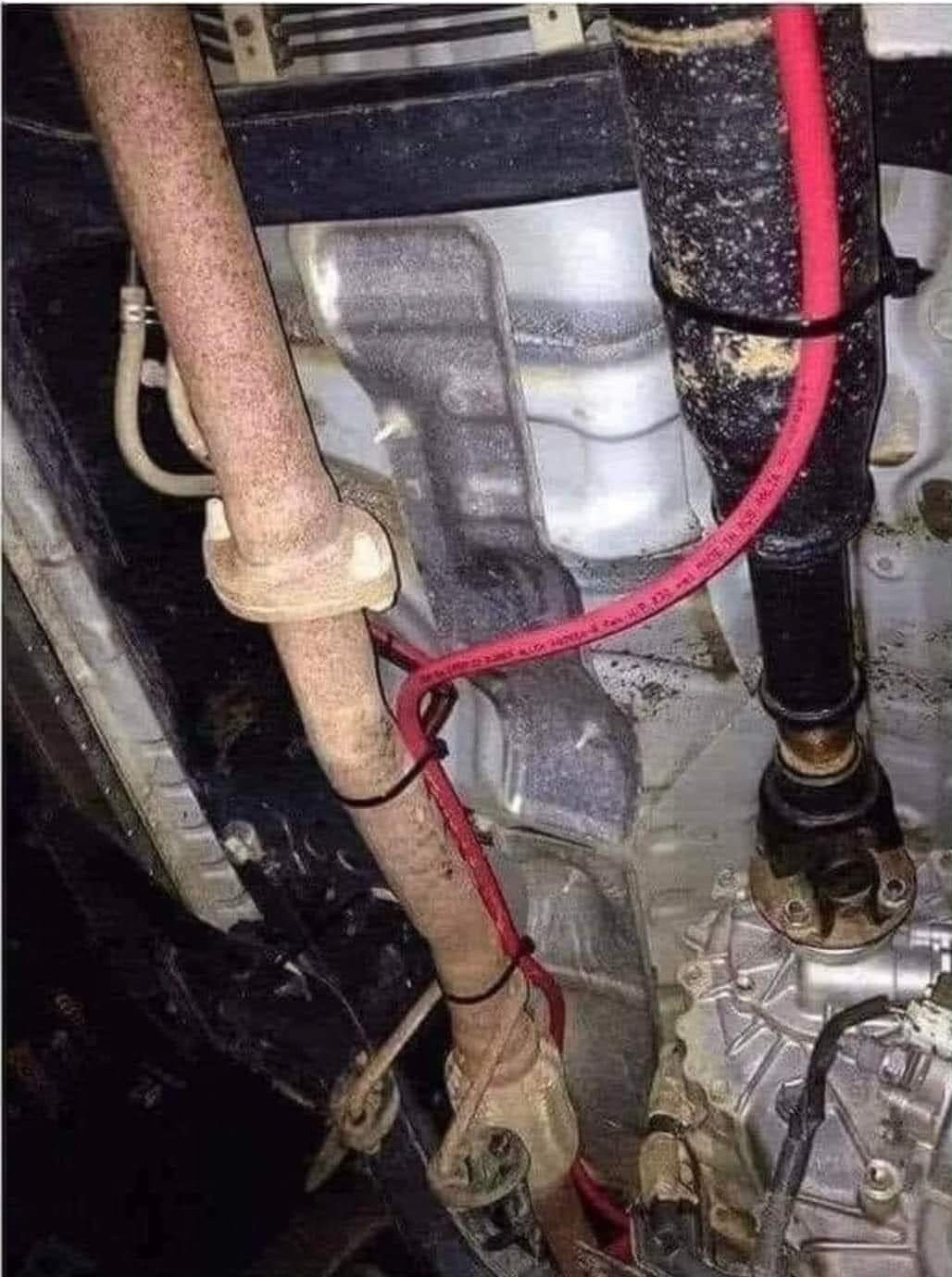

Thought that was your diesel heater fuel pipe.
