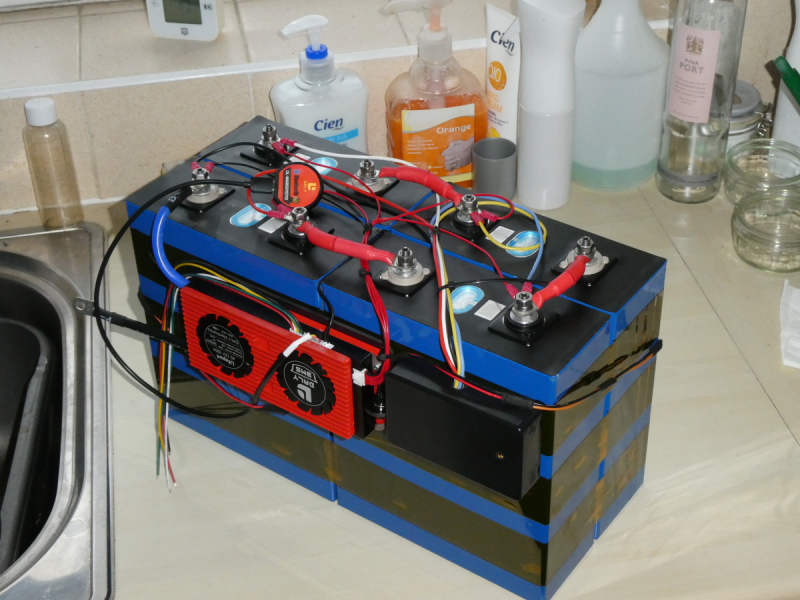

Here's my latest home build Peter, 280Ah with a bluetooth BMS, it's all pretty simple stuff, no rocket science involved.
That photo will give peterc10 nightmares.:LOL:
That's exactly what is inside most prismatic lithium batteries without the fancy plastic box but you can get one of them if you want
I've come out in a bloody rash all over. :oops:
£41.19 18%OFF | 12V 24V 48V DIY Kit Battery Box 100ah 120ah 200ah Li Ion Lifepo4 Lithium Battery Diy Solar Cells Waterproof Plastic Empty Case
Makes it into a nice neat job.
