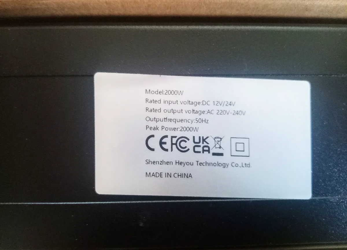

Normally, an inverter will have a sticker, (or Users Handbook), that reads something like,
Peak Power 4,000W
Continuous Power 2,000W
Or something similar.
The Peak Power rating caters for the start up surge current when you first switch on the hair dryer, etc.
The Continuous Power is what the inverter can run on happily without getting stressed and shortening it's life.
As many have mentioned, batteries are important also.
Ordinary lead-avid batteries should not be drained lower than 20%, on a regular basis, or they will also not be long for this world also, dying right about the time the guarantee runs out.
LiPo batteries are the way to go, but as they are marginally taller, they can sometimes not fit inside the battery box compartment, like my Knaus, where ordinary AGM batteries have to be shoe-horned into the compartment.
Most good quality LiPo batteries are fitted internally with a BMS (battery management system) making a lot of the discussions about needing special charges for LiPo batteries irrelevante.
The best rule is always oversize inverters and batteries, it's less expensive in the long term.
I've attached a couple of images of a typical inverter specifications, not mine, but might shed some light on the mysteries of inverters.
Good luck 🤞
Good luck 🤞 View attachment 990244
View attachment 990245View attachment 990247
Sorry but I have to disagree with several of your statements.
You say that lead acids should not be drained below 20% regularly.
They should not be drained below 50% unless you want to damage them or shorten their life.
You state that LifePo4 with a BMS means that lithium specific chargers are not relevant.
If you want to get the best out of your expensive lithium battery then a lithium specific charger is needed.
A charge source that doesn't have a lithium setting will never get the best out of a lithium battery.
Also the BMS should be the last line of defense not the only line of defense.
Finally you say that if you push an inverter to its upper limit it will not last long but then say that the 2,000 watt continuous rating is what it will happily run at continuously without getting stressed.
Some incorrect and confusing advice there I'm afraid.
