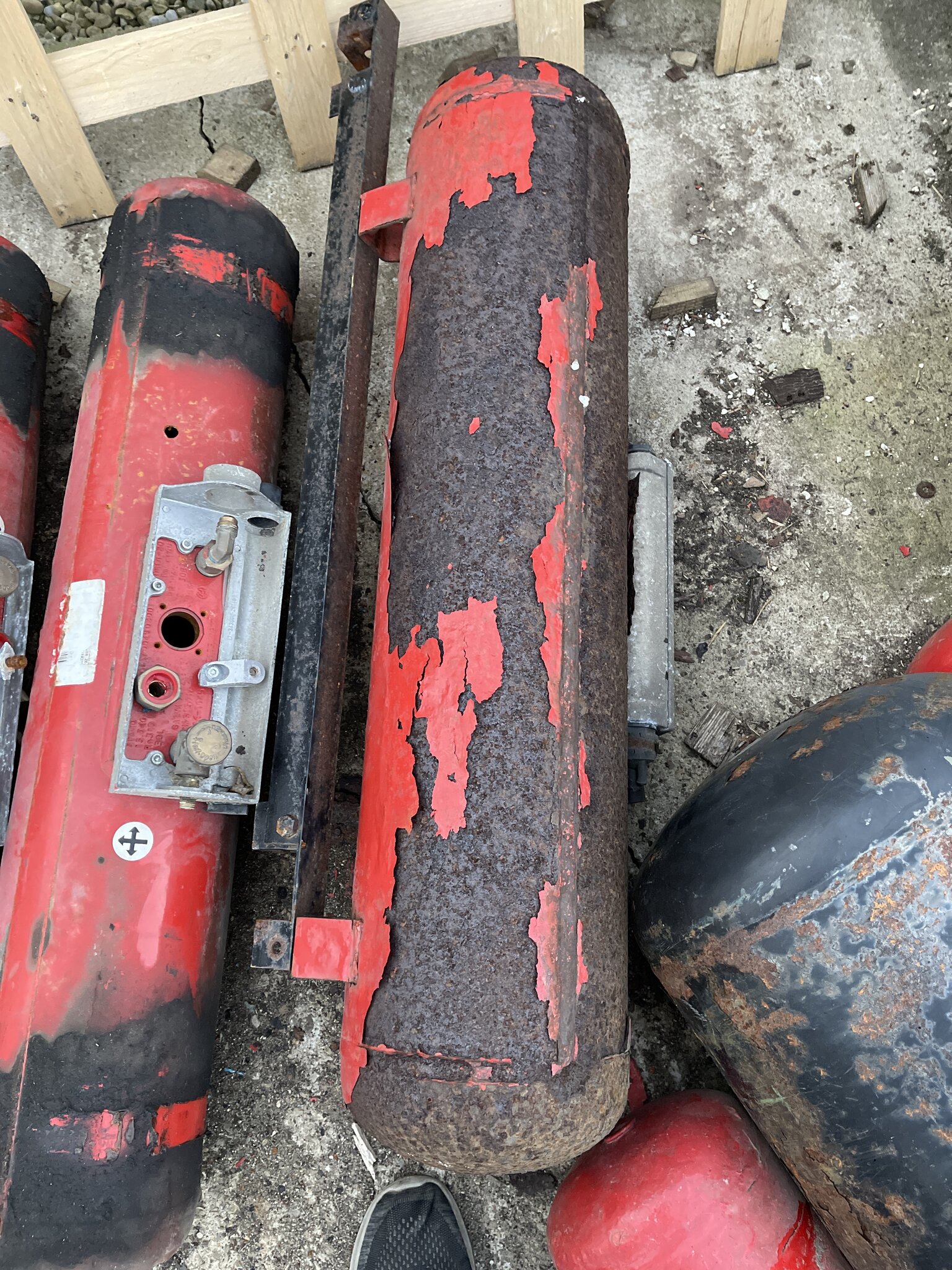

That’s exactly what the codes of practice state that you need to do at 10 years.Okay so when I get back from Spain in March I will take up the floor in my van, remove the insulation, disconnect the filler pipe disconnect the copper pipe to the regulator, unbolt the Autogas 2000 Caratank from its lugs and so on. There has to be an easier way unless your tank is only safe up to 10 years.
Tank should be removed.
Filler hoses replaced and regulator replaced.
Yearly inspections have always been recommended too as that too is good practice, you can do this yourself easily enough.
