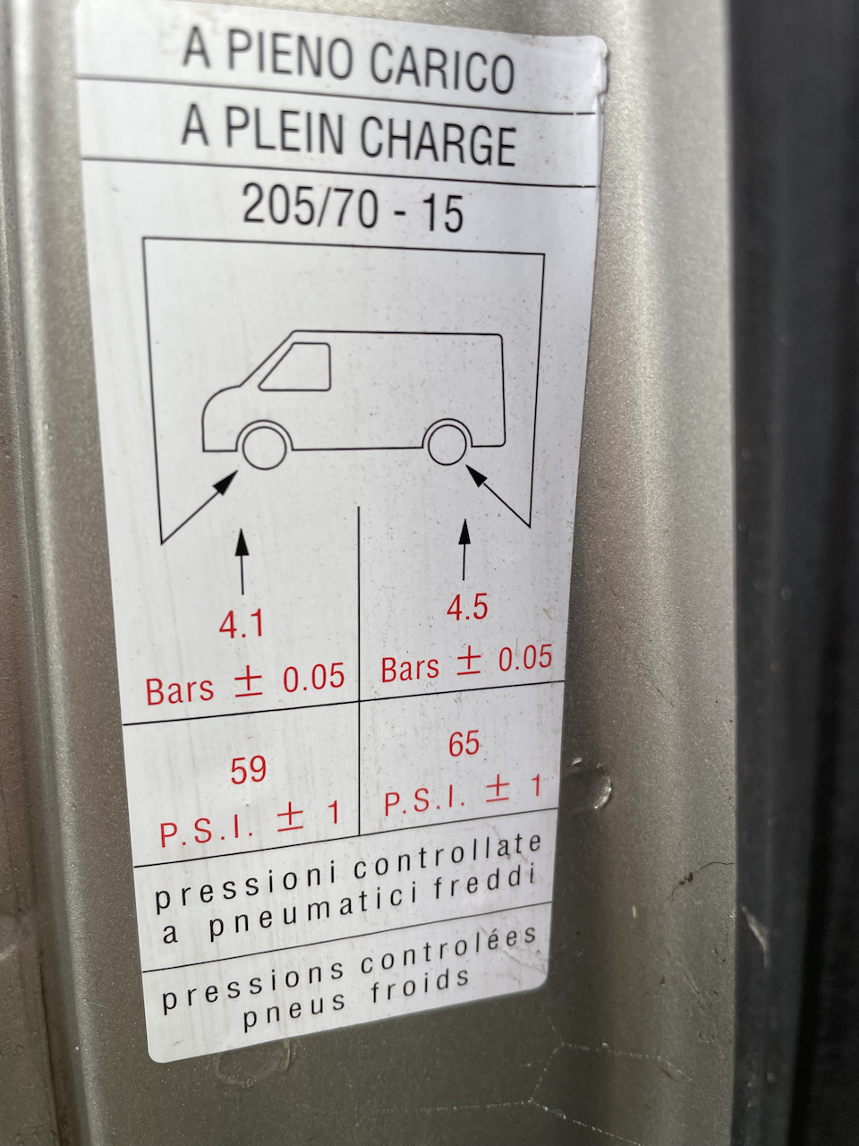

As said, the correct size tyres and pressures are on the data plate on the drivers door pillar or user manual.. but only correct if you have a PVC or coach-built on a van chassis that has not been up plated.
On a tag axle or coach built with an Al-Ko chassis they will be different from the original base vehicle data ..
This is the sticker from my Ducato 2.8JTD .. LWB panel van . MAM 3,300 kg
4.i and 4.5 bar ... 59 and 65 psi
