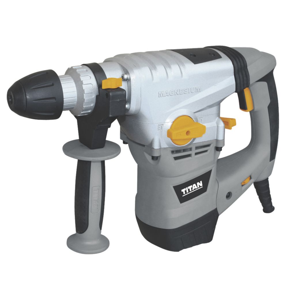

Rapido 854f
Since 2012
Agree you need a decent drill and this is easily the best overall value for money power tool I've bought
I have an identical drill by a different name. Well 2 actually as it happens, as after a few years hard use one became slightly temperamental and as I suspected a motor fault bought a replacement. The old one then decided to work again when next tried. So must be a wire or switch issue

Yes, I had one of those. The cheap motor eventually burnt out after 5 or 10 years, so I bought the next model up, which was lighter in weight, more ergonomic layout, with more Joules per hit and had a touch sensitive trigger. Still cheap as chips and 100 times faster than the most expensive conventional "hammer" drill. I still have a decent "hammer" drill, but the hammer is always off and it is used as a high quality twist drill. I wouldn't buy an expensive SDS drill, as I abuse them.
