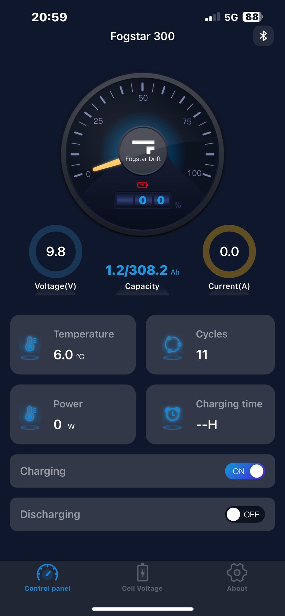

Fogstar drift 300 is on zero showing 0% battery at 11.2v :-/
Start the van up and the alternator is definitly charging it so guess it's just depleted over time, but here's the question, should the toggle be off or on if leaving for a while with crappy sun? ie if I toggle discharge to off, I'm assuming that it will simply keep charging until full, then when I need the battery to power the lights etc switch to on?

Been a crap 2 days at work and Nope it's worse :-( And Im going to the campsite tomorrow :-(
That, is dangerously low, at 10v and perfect balance you reached the absolute lowest allowed 2.5v per cell x 4 = 10v. Allow for a bit of imbalance, and 10.4v would be the lowest of the low you should go.
Remember, lithium when it goes, its done. It will never come back. You been very lucky at 9.8v .
Goes to show how well that bms is set, NOT.
