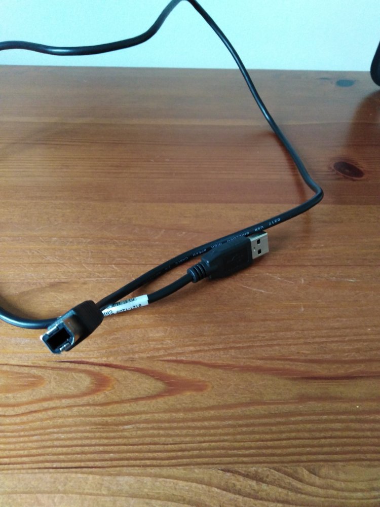

Anybody managed to update there system with Intelsat on it?
This is the cable you need. USB printer cable. You put it outside box, simple when you have the correct download and cable.
That's what I thought but tried all directories of the install program without success. Has anyone who has done the upgrade got a copy of the file?Wherever you downloaded the update to, or extracted it to if zipped will be where the file is. Do a search for the file and it should find it.
