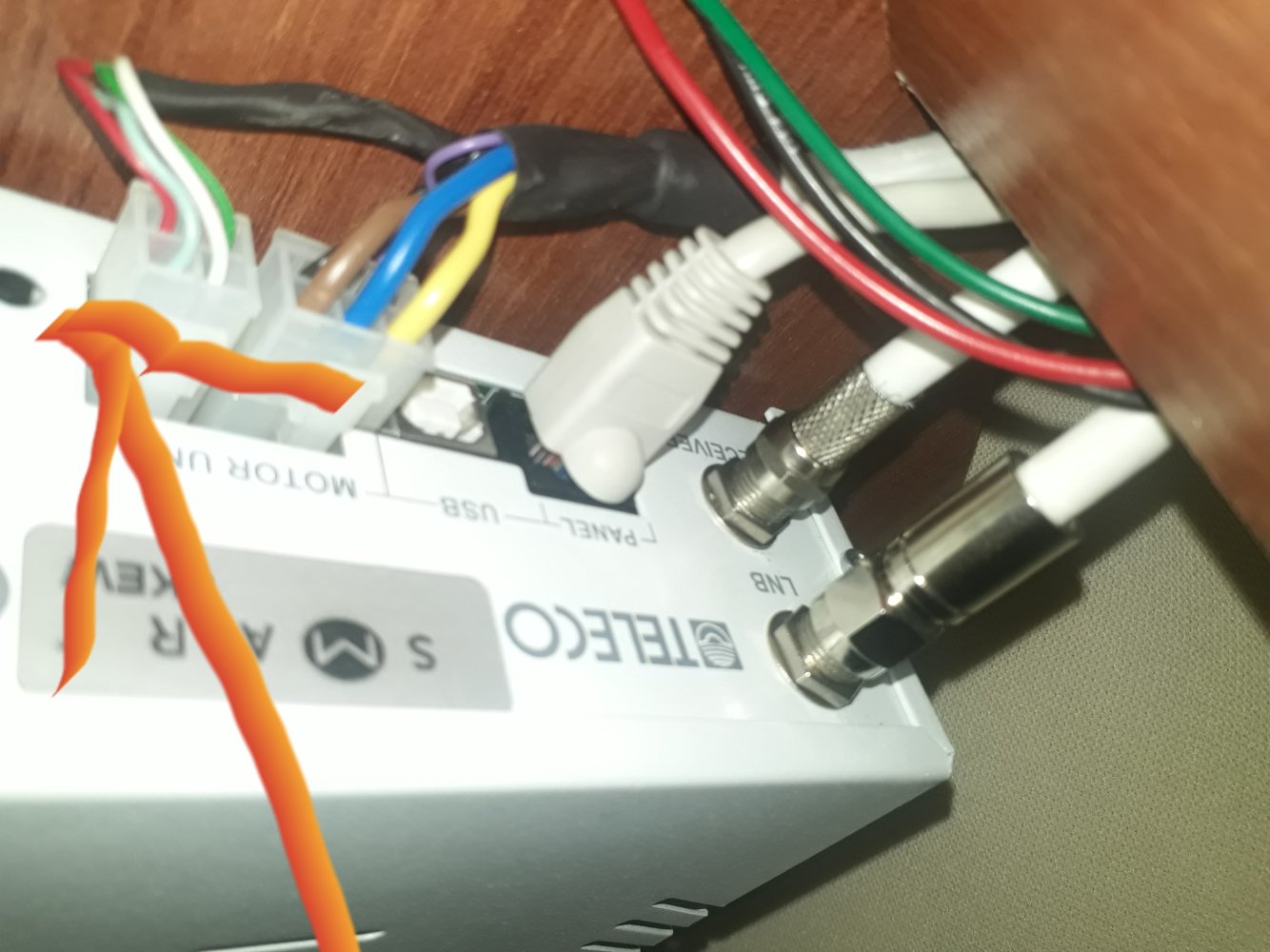

You have to plug the cable into the teleco control box
There should be a sticker on top of your control box mine is the easyskew system
You can see from the picture the cable needs to go into the port marked usb on the box

Just found our box behind a false panel above the fridge. Very hard to get to. Will give it a go tomorrow. Can't see the name yet.

That looks like it's going to be hard work, try taking a photo with your phone to see if there is a label on the end of it, failing this there will be a serial number on the plate where the dish is on the roof
Also you may need some help as you need to hold down a tiny black button on the end of the box whilst turning the dish on at the same time as holding the button down so how far away is your on off switch compared to your control box
You can just make out the small black button in my picture with the arrow going to it

It's not hard to do once you have
Found which system you have
Download the correct file to laptop
Connect cable into sat box and laptop
Get someone to turn dish on whilst you hold the button in for a few seconds
Download file to sat box

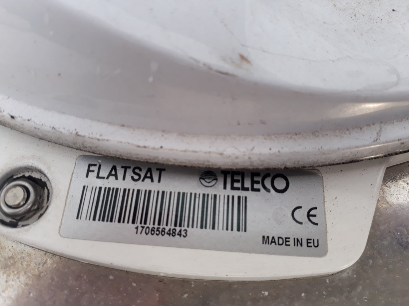

This is what is only the satellite dish. Do you think it's the flat sat easy update we need?

What is on the dish face, they normally have stickers on saying what model it is. From the LNB picture it looks like a non skew Flatsat system.

Can't see anything on the dish. A Dethleff sticker is over it. Sent S/N number to teleco so hopefully get make from them.
