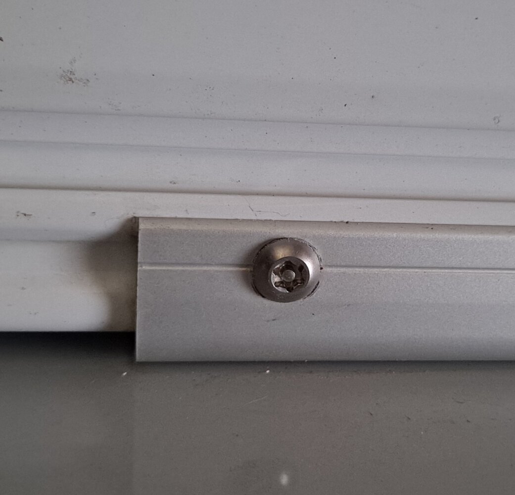

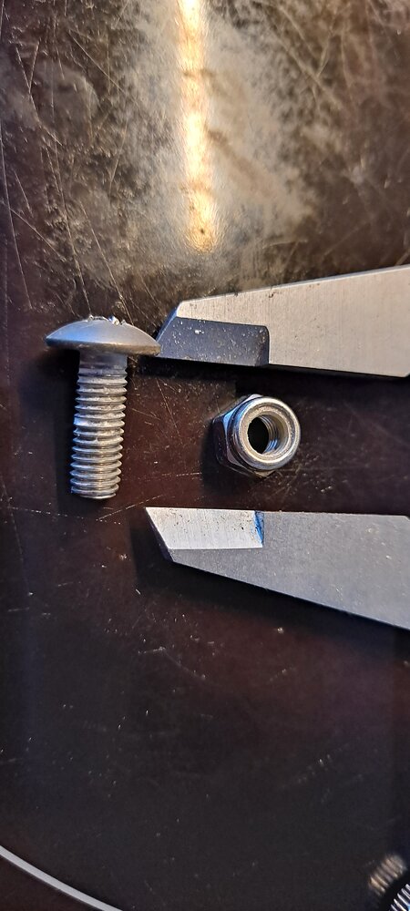

This awning has three HD plates that bolt through the MOHO, then the awning hooks onto plates then secured by three bolts through the bottom, so easy removed.
They aren't self tappers, they are 15mm M5 bolts with a nylock nut.
So you have to wind the awning out a bit to get a socket on the nut.
So a straight swap for these maybe 🤔 unless Mr thieving bugger has a full torx tool kit..
With these on top it's never coming off 😂 it would have to be unbolted from the van 😎

If anybody fits these shear nuts, just put a small cut in each side of the nut with the junior hacksaw to weaken the shear point, otherwise it gets really tight and crushes the aluminium before shearing. Just fitted the middle one on ours and standard nylock nuts on each end with the tamper proof bolts.
