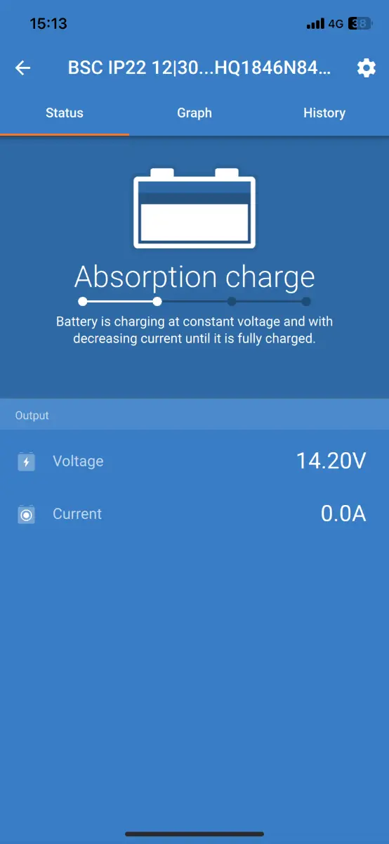

Charger is definitely powered up and battery master has power to it, the van was outside today so charge went up to 65%, charge is showing this on app,
So does this mean the batteries are nearly charged? If so then why does the panel inside state only say 65 charged, I was of the thought they went into absorption mode when nearly or at 80%

3. If you say the charger is on, then my guess is there is a blown fuse between the charger and leisure battery or the charger isn’t working (wrong settings?).
Don’t think it will be set up wrong the previous owner was electrical engineer I think, but I’ll check the fuse if I can find it
4. Have you got the Victron app on your phone so you can see the charger settings and current status?
Pic posted below of current status

Also the blue photo if thats the charger, then the charger is in absorb at 14.2v, but 0amps; looks like open circuit to me, or no battery connected.
