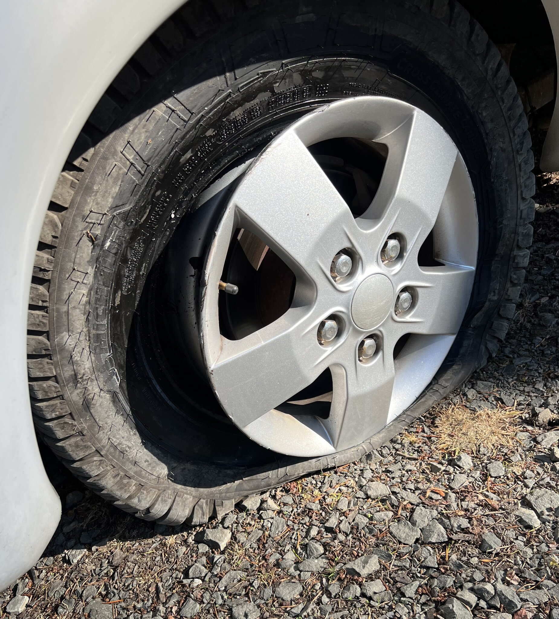

I used to carry trolly jacks, but luckily I also carry quite a stash of wooden blocks and thank goodness I do. When youā€™re faced with this, in Northumberland, and you live in Kent, youā€™d be pretty stuck with bottle jacks and trolly jacks. My only solution here, was to drag the rear up on the ramps and get the issued scissor jack under it, then by combining the blocks of wood, building up the rear and then getting the jack onto the wood, youā€™d be lost. Don't even consider trying to use the useless gunk that the manufacturers want to fob you off with, just so that they donā€™t have to provide a spare, save weight and money, as it ainā€™t gona work.

The level ramp what a good idea
Was the only way Iā€™d have gotten the small scissor jack in. Carrying bottle jacks and the like, just wouldnā€™t have fitted under it. Mind you, if thatā€™s all I had Iā€™d have dug a hole to start with and then worked my way up on the wooden blocks.
