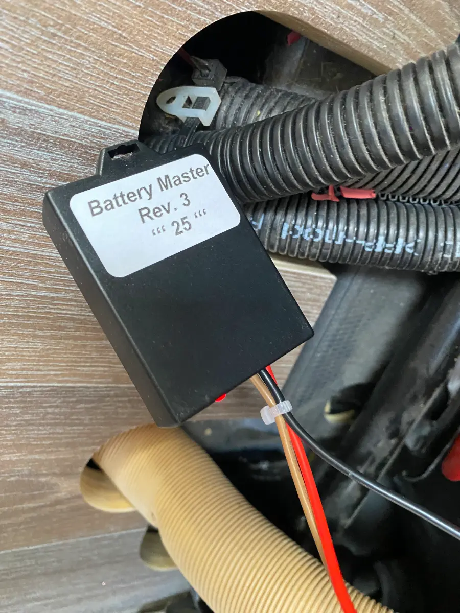

Another big thumbs up for the Vanbitz battery master fitted this weekend …… 👍. Works a treat.
