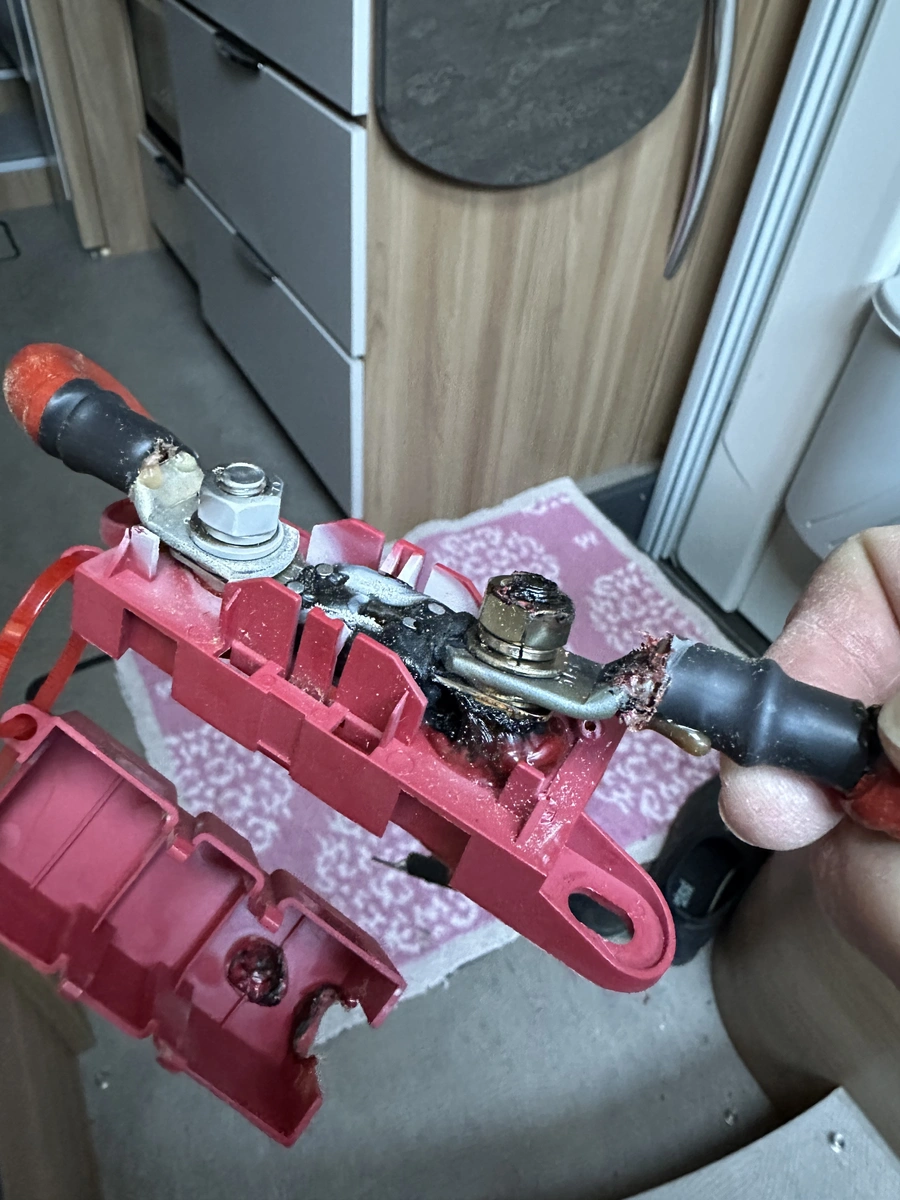

If real world evidence is needed, below is my personal experience of what can happen when you have a short circuit whilst using a correctly 'rated' (genuine) Mega fuse on lithium batteries. Not ideal and a big learning curve. I was annoyed at myself as I originally had ANL fuses, which were fine, and swapped them out for Mega simply because I preferred the holders!

I don't know, but certainly more than enough to blow the fuse so can only assume it had bridged. Judging by the way the scorch marks are I believe this is what happened.
