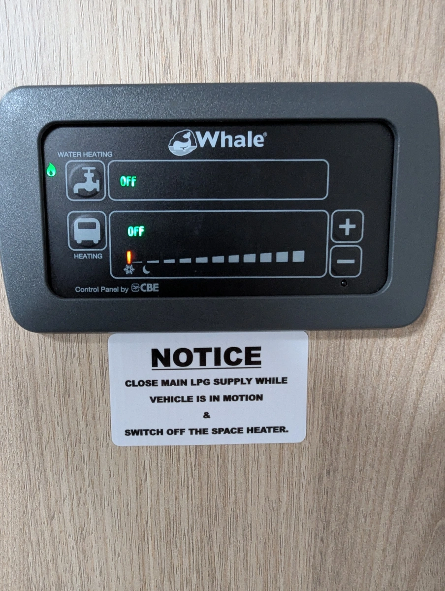

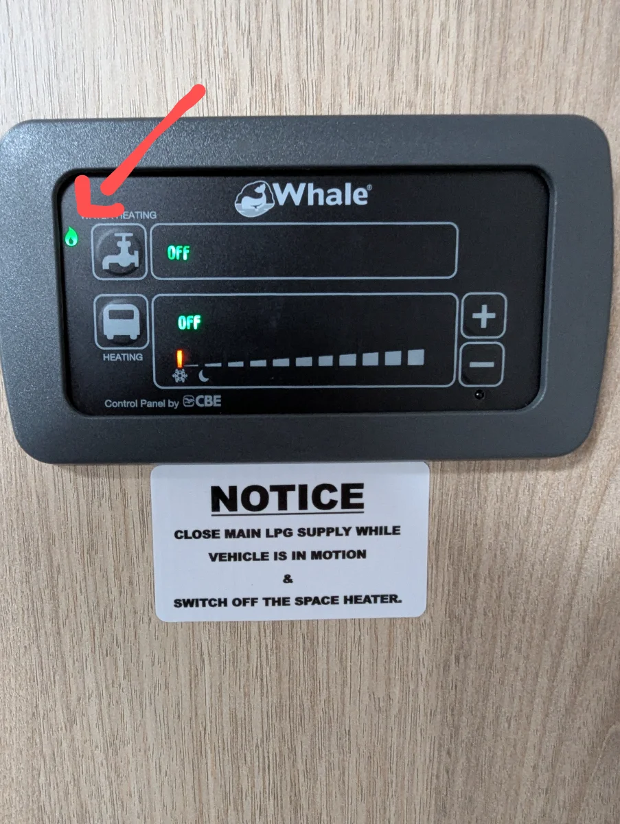

I've attached a picture of the control panel, which displays the little flame and two wavy electric symbols as soon as I power up, that's not right is it?

Does anyone know if this flame should be displayed ALL the time, even when off?
