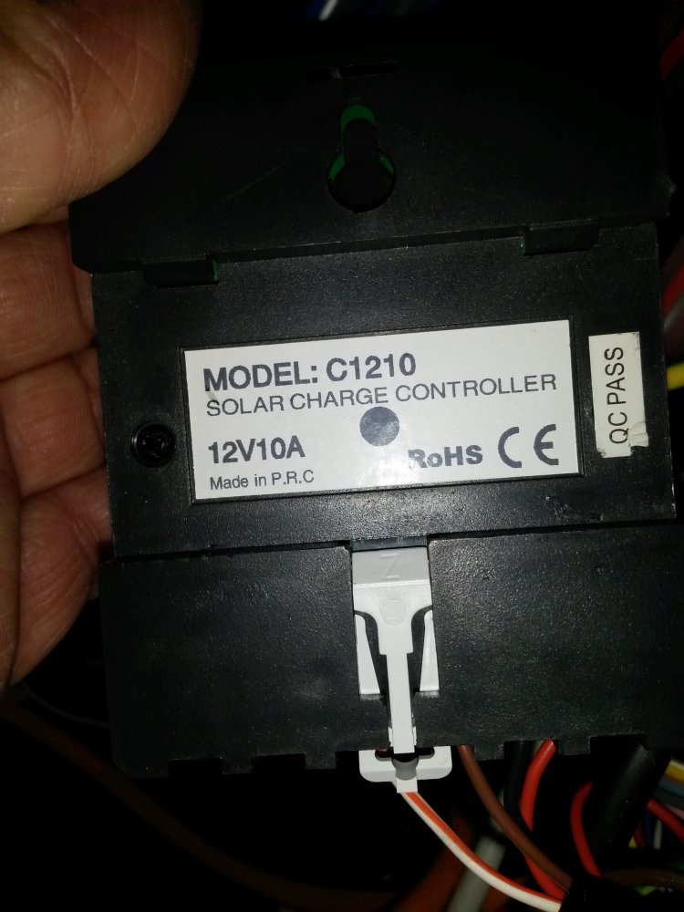

Inside the EC500 there is a C1210 aftermarket regulator, which your connecting to when you plug your solar panel into the rear of the EC500
I've just taken a photo of the external C1210 controller, I can't imagine Sargeant fitting another inside the EC500
Not even made in Taiwan like all good electronics :ROFLMAO:

I can't see a downside to replacing the original controller with a Victron 10 amp MPPT controller and adding an extra panel.
This way the new controller will automatically limit the maximum solar energy to 10 amps to protect the Sargent EC500 which directs power to the required battery (both vehicle and leisure batteries) intelligently and I can still monitor the load and solar output via the EC480 display.
Taken from the Victron site
1a) If more PV power is connected, the controller will limit input power to the stated maximum.
I looked at the Taiwanese option but the smallest controller has a potential output of 20 amps
