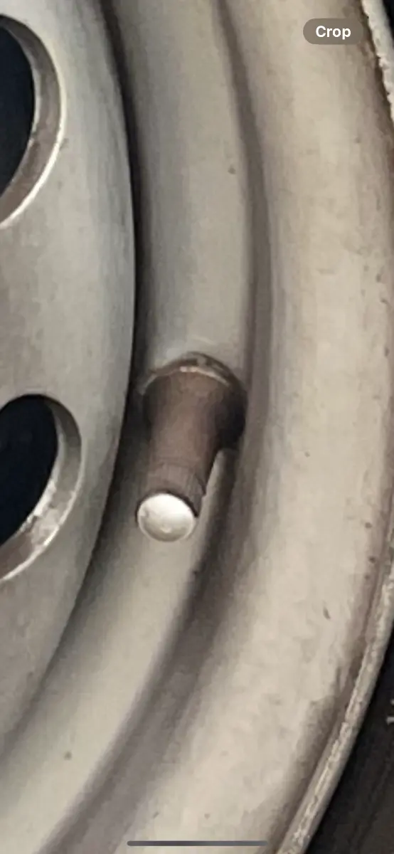

What valves have you got in at the moment?
Hope this helps, not to sure as first time changing Moho tyres

Not sure only had the Moho for 1 year and the tyres are 7 year old

If they have a brass core that sticks out above the rubber they are high pressure valves.
My new van came with those on the front and full metal ones on the rear.
