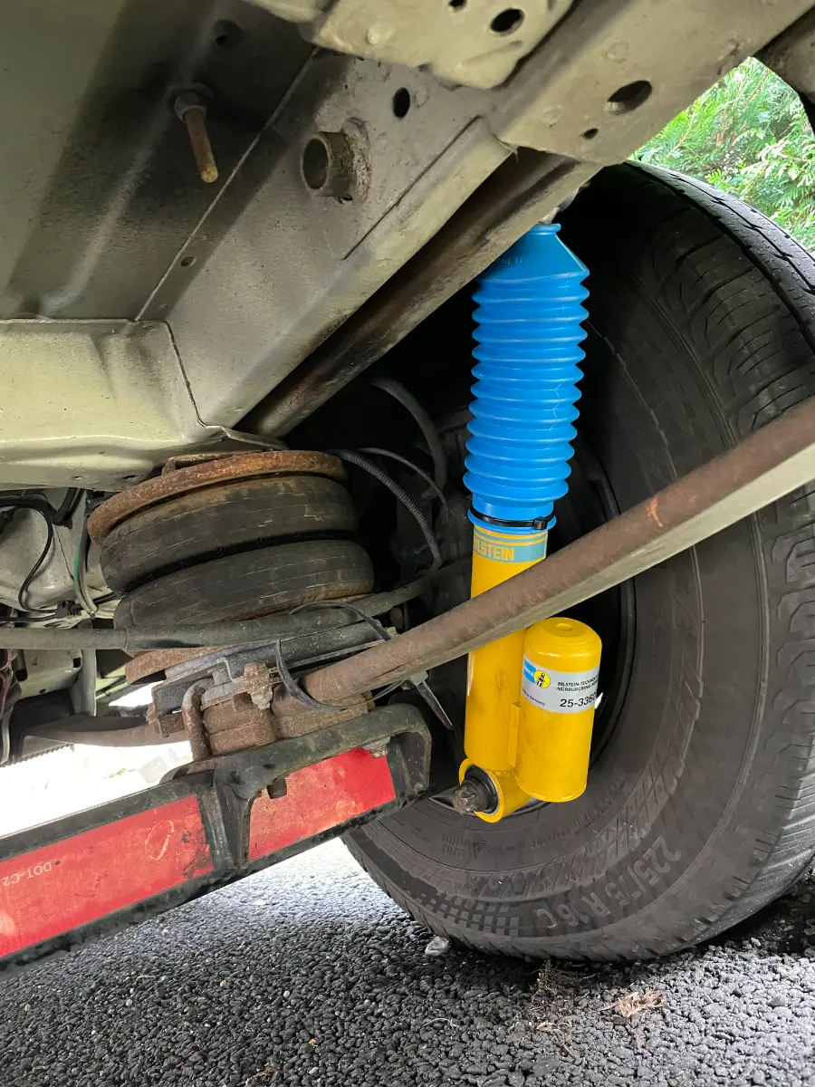

In October last year I fitted Kilen 12181 coil springs when I replaced the standard suspension with Bilstein B6 Camper Advanced dampers. This is on my 2020 Boxer heavy chassis panel van conversion.
The 12181 springs are rated for front axle weight up to 2000kg - my weigh bridge front axle weight was 1800kg. The spring comparison pic is the 12181 next to the standard maxi chassis spring. The ride height after fitting is plus 54mm.
Removing and replacing the struts is possible without removing the driveshafts or bottom ball joint. As others have said - need to be careful not to pull out the passenger side driveshaft when removing and replacing the damper unit from the hub. I didnt lose oil but did have a container underneath as a precaution. A helper is recommended for reinstalling the struts to line up the 3 strut top bolts as the struts are heavy. The trickiest bit was accessing the drivers side strut top - see photo. There are 2 security bolts (the type with sheared off heads) that need to be removed that hold on the cage round the BCM. Compared to the original suspension the improved ride quality, stability in cross winds and reduced noise has been very impressive. Probably the best mod I have done to the van.
