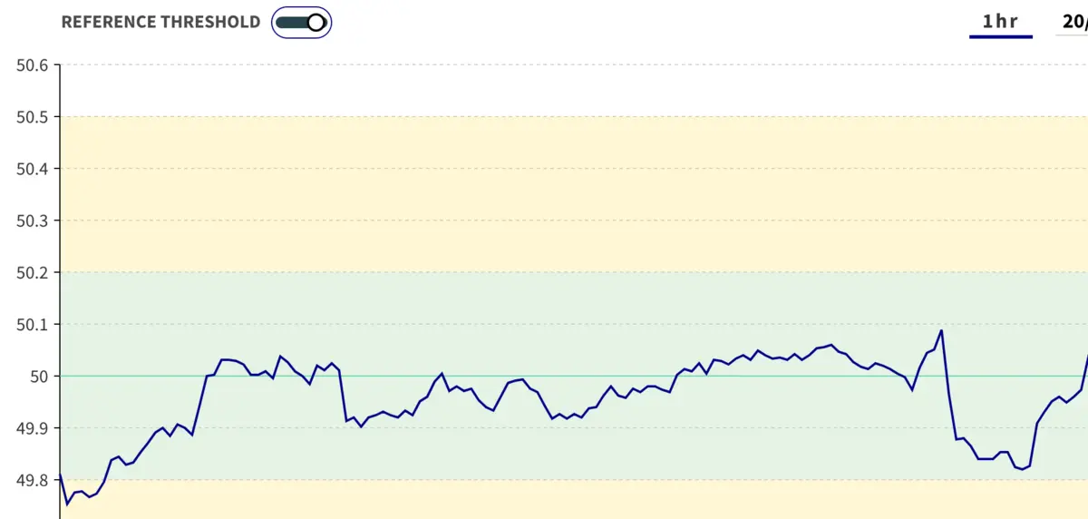

Again likely an issue, the grid frequency tonight is falling to below the operating margin. If everyone pops to put kettle on after this inauguration speech from Trump there may be issues. (if a lot of people are watching it).
It may be averted by the populace opening a bottle of beer/gin/whisky/vodka while chuckling..."here we go again, strap in for the ride..."
I agree, the drinking in our case likely saved the grid a bit, we did have a huge frequency drop at 6pm though.
The bad thing though 1GW margin isn't much, and we have a worse weather day tommorrow by the forecast. I'm definitely charging my batteries tonight.
I'll edit to point out the grid fell below its reference safe target frequency range at 6pm. (the yellow).
