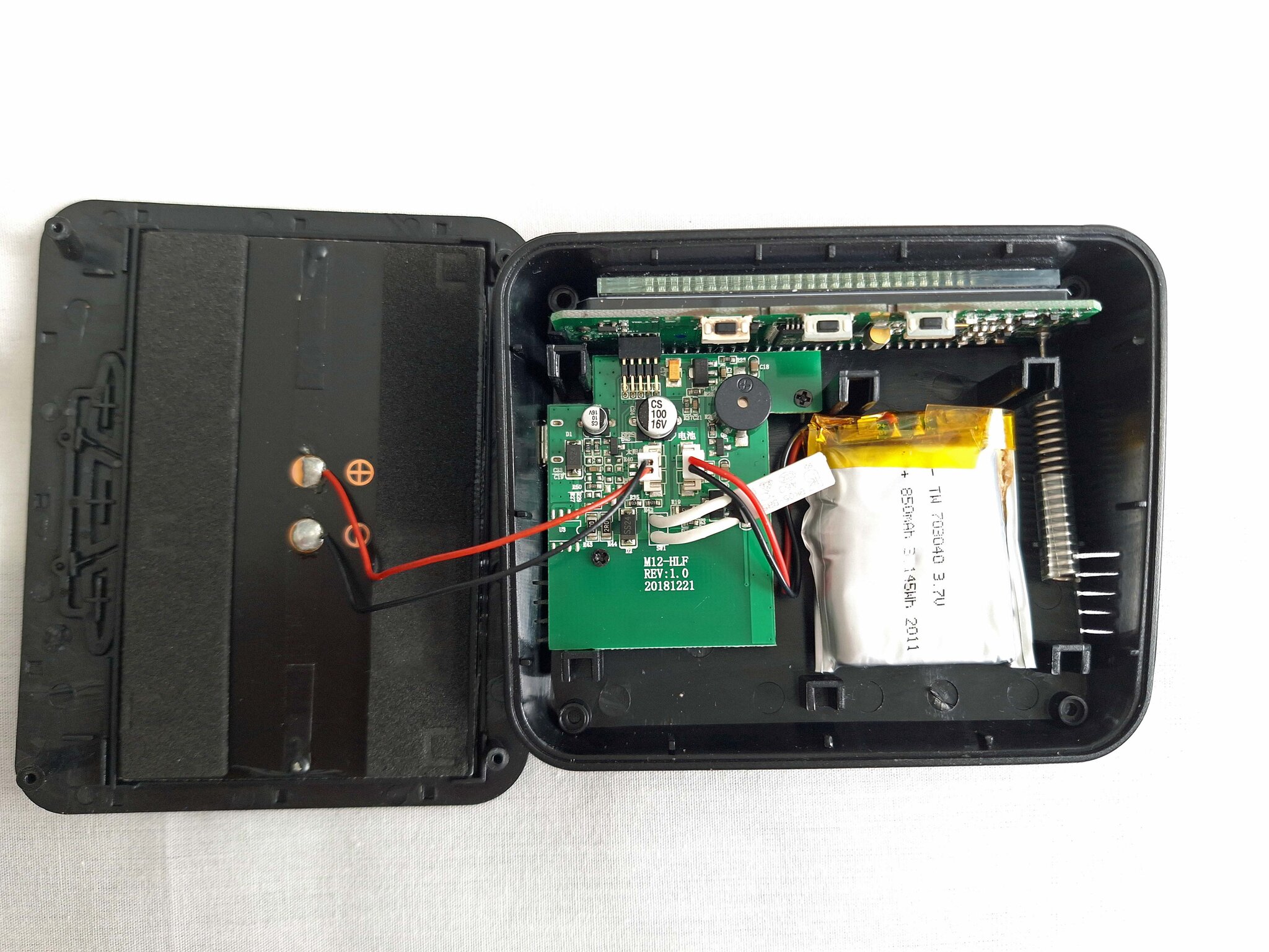

Replacement wasn't at all difficult (particularly compared to the Nextbase 522GW battery that I recently replaced). After removing four tiny screws from the base of the unit, the top lifts off easily to reveal this:

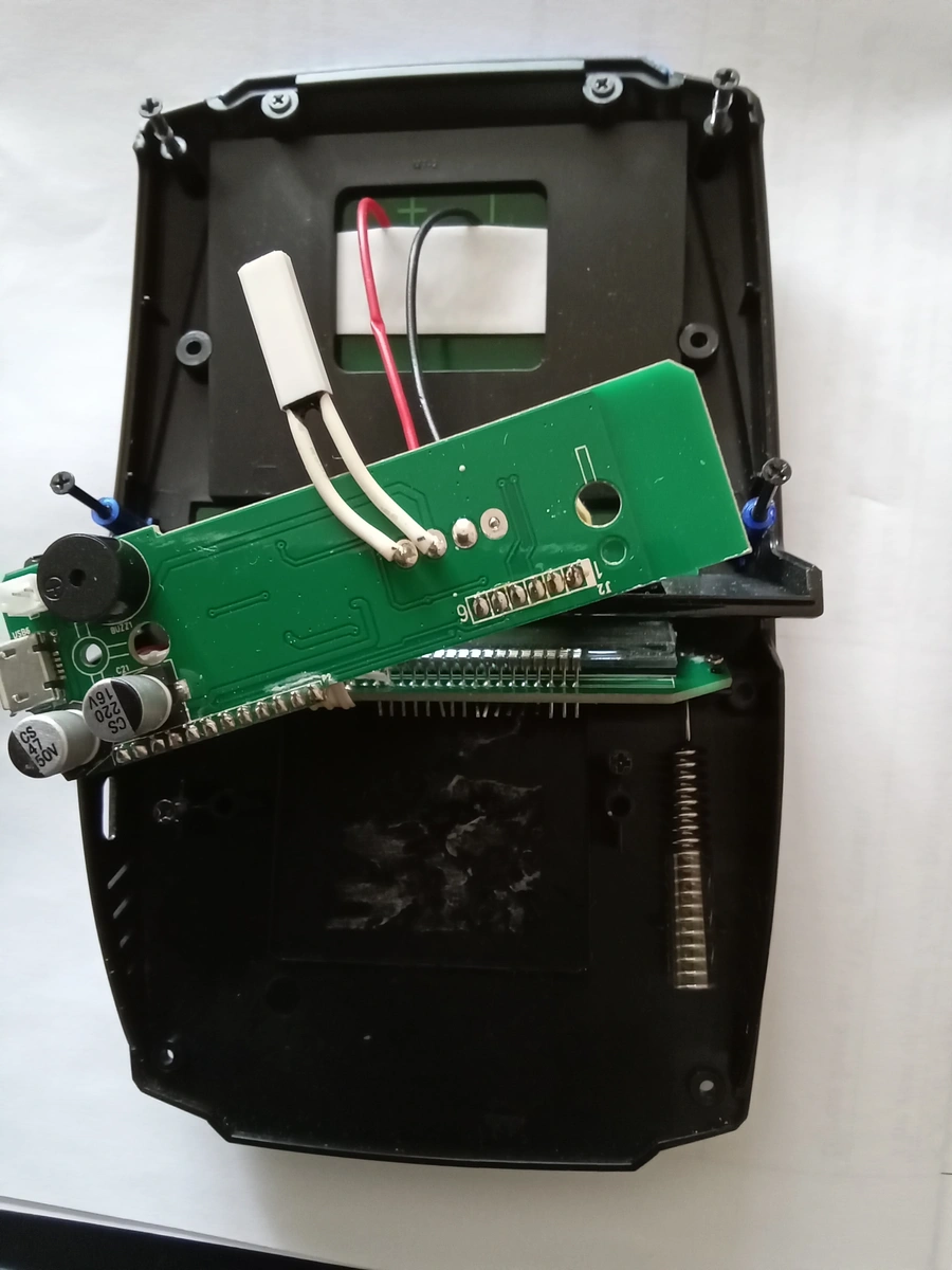

The battery is held down with some super-sticky black tape so needs carefully prising off with a wide-ish blade. It's best to first pull out its miniature plug from the circuit board. Some available batteries already have a miniature plug at the end of their wires but be aware that sometimes the polarity isn't correct (i.e. wires reversed). The batteries I bought had bare ended wires so I simply snipped the old battery's wires at about half way and soldered the new battery's wires to them, covering the connections with heat shrink, and matching the wire colours. A small piece of double-sided adhesive tape held the new battery in place and I also put some electricians tape across the upper face of it to insulate it from the exposed soldered connections on the underside of the solar panel (see photo). It was just a matter then of inserting the mini plug into its circuit board socket and switching the unit on briefly to check that the screen illuminated, which it did. Finally, replacing the top solar panel and fixing it with the four screws.
I then charged the unit through USB, which didn't take long to full charge. The TyrePal User Guide says that the original battery should last 60 hours between charges and it certainly seemed to last a very long time while used in our MH. It will be interesting to see whether the replacement battery has similar life. After several days it's still looking full.
