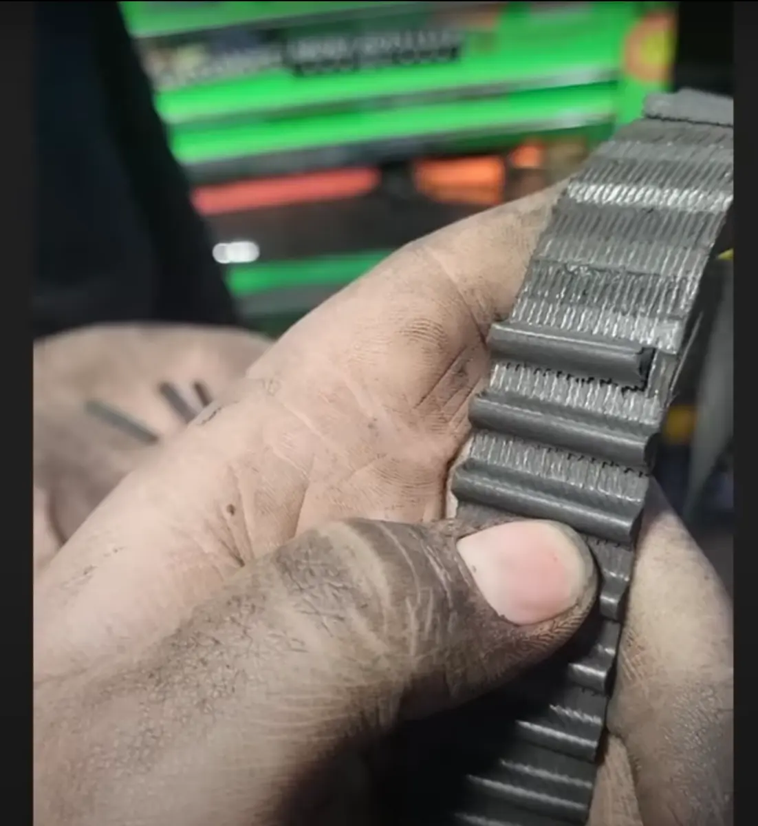

I’ve posted before, from a Skoda Yeti. In for its belt change and just in time. It was still actually running, but probably not for much longer. I know you said about the squiddlies, but it’s a game of Russian roulette, with hundreds versus thousands. Do you feel lucky.
