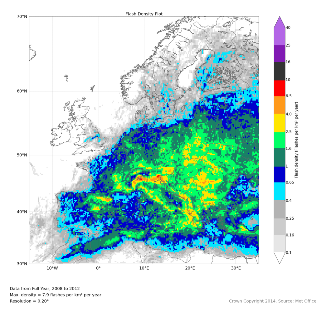

This map shows why in the UK we are not very concerned about lightning spikes. If you look at some of the worst concentrations, in South Germany, that's where Schaudt (who make Electroblock and OVP units) are located.
A few years ago we had an Autosleeper. It was plugged into the mains at home in Kent and there was a thunderstorm overnight.
Next day, the EHU circuit breaker in the house had tripped, as had the vans, and the heater elements in the Truma 4 had blown.
The UK may not get much lightning, but when it does, it’s good stuff!
