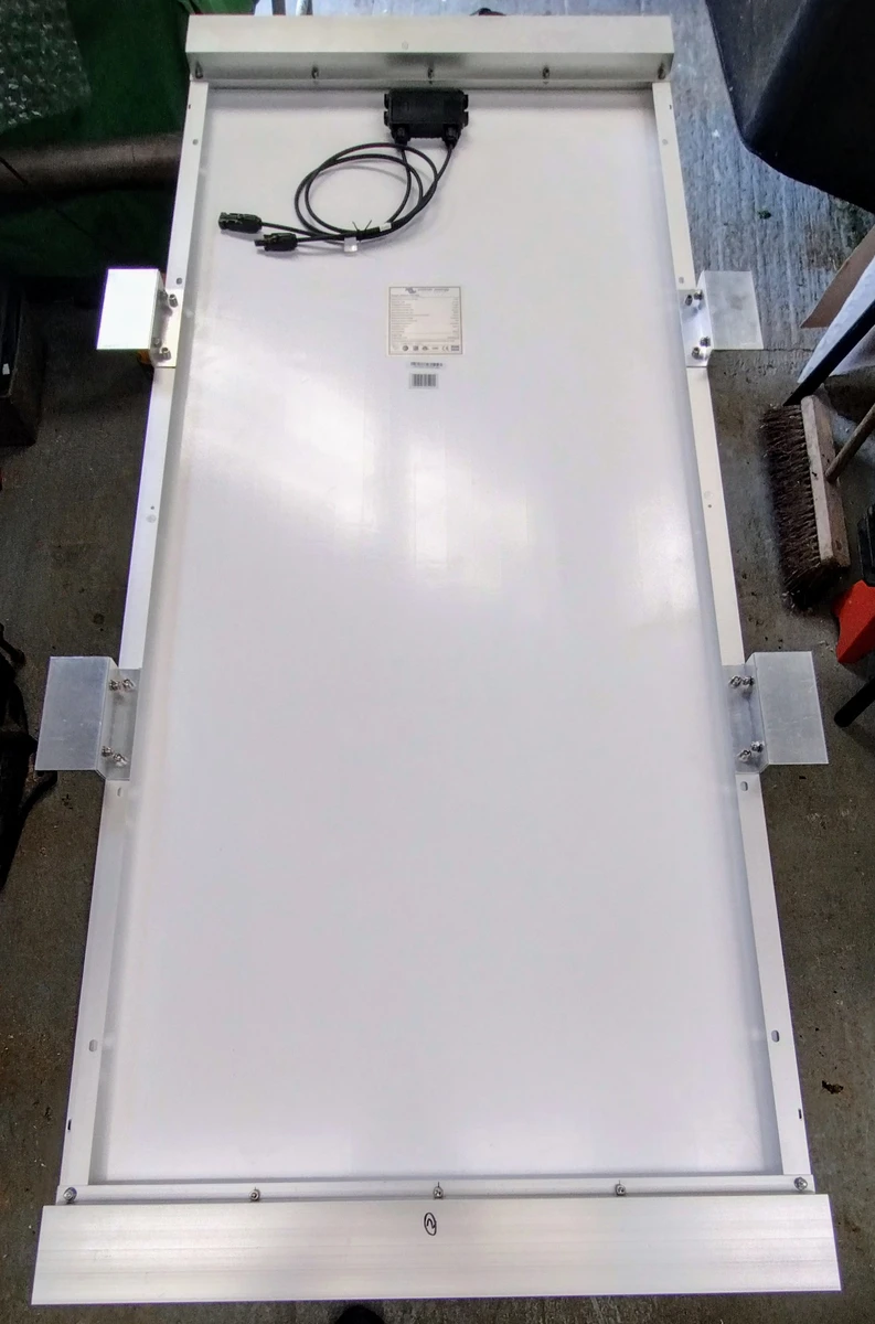

can I ask a tiny diversion question - what brackets do people use? their are the obvious plastic corner ones sold everywhere but they go yellow over time and don't look that elegant. I am wondering about using simple 50x50x3mm aluminium angle https://www.aluminiumwarehouse.co.uk/products/50-mm-x-50-mm-x-3-mm-aluminium-angle . Bonded on horizontal part to the roof - coachbuilt in my case - with 3mm lift from spacers, and bolted (bolt, washer, frame, washer, spring washer, nyloc) on the vertical part to the panels frame ?
