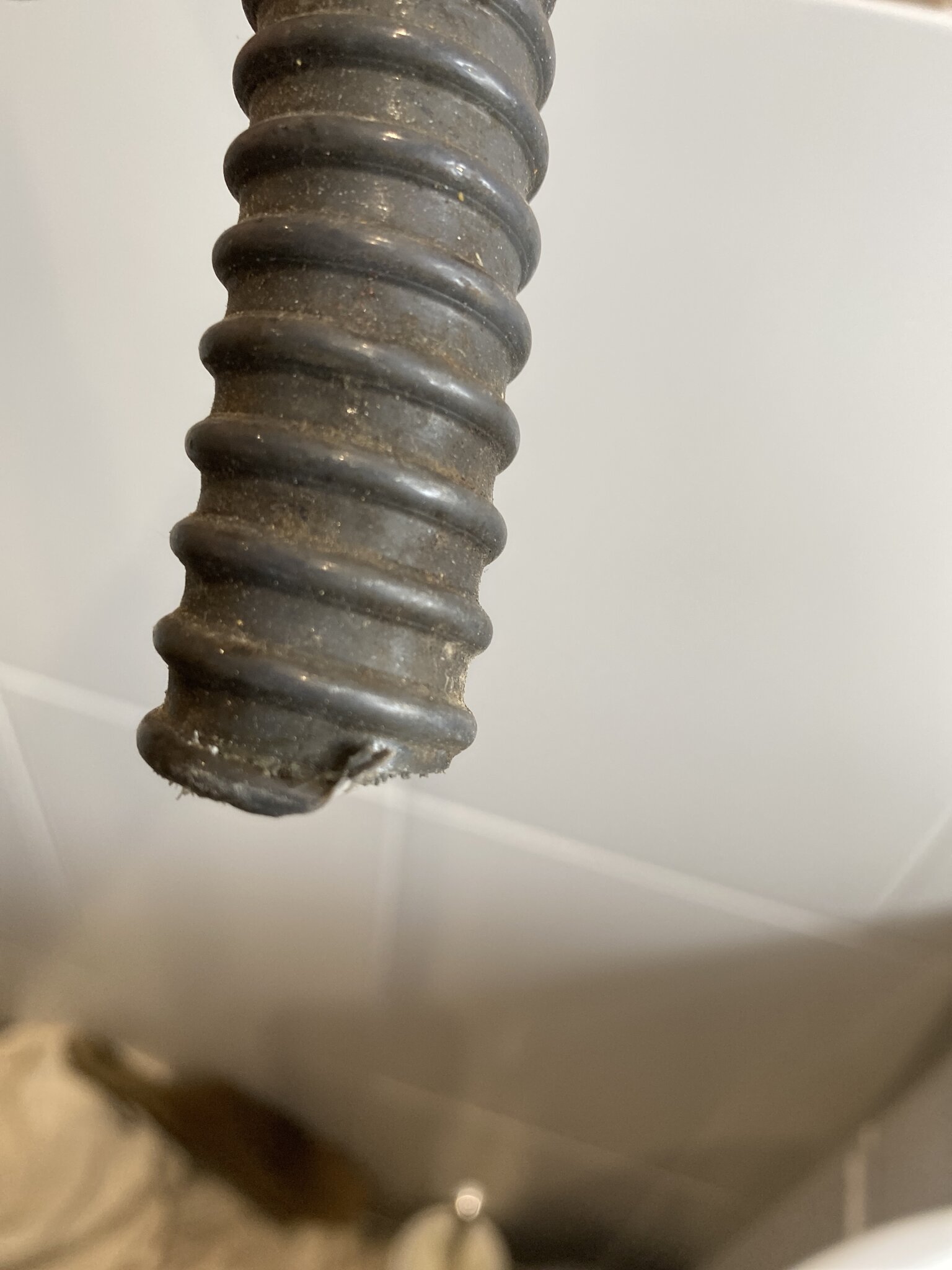

The pipe isn't even convoluted. The pipe is smooth bore with a spiral reinforcement on the outside so it doesn't collapse when formed round bends (or around pulley formers).
I thought you may have had this conveluted that has spiral exterior it’s sort of smooth inside but would still guide a flow
Not sure what you mean.
