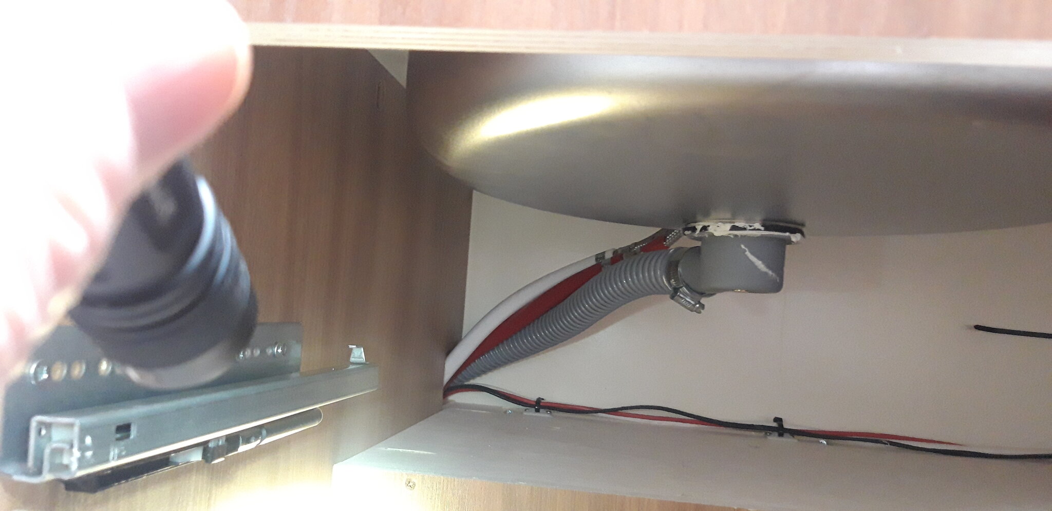

The pipe is of the flexi type (see pics i was asked for).
The drain in the bathroom looks like it's running uphill, even with my limited knowledge i know water don't run uphill.

Ours is slow too. I put it down to the shallow shower type combined drainer/ubend. It's like that to clear the drawers. Yours looks similar to ours. Little chance of yours being blocked because it's so new.
I think you'd get a better drain with a lower/ deeper trap. But you may be limited on space below.
