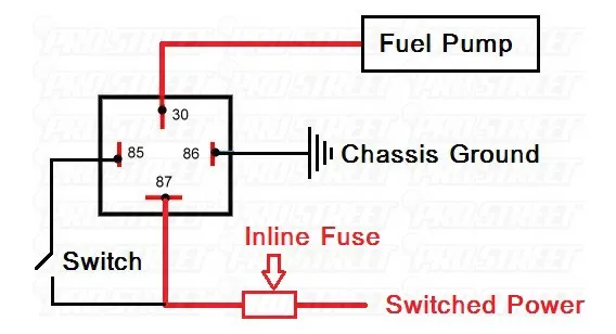

It is good practice to install a relay as it takes the load off the switch.
The fuel tank lift pump draws about 4 amps, which is only running for a short period when the engine starts, as it's only priming the diesel pump during the engine starting phase.
