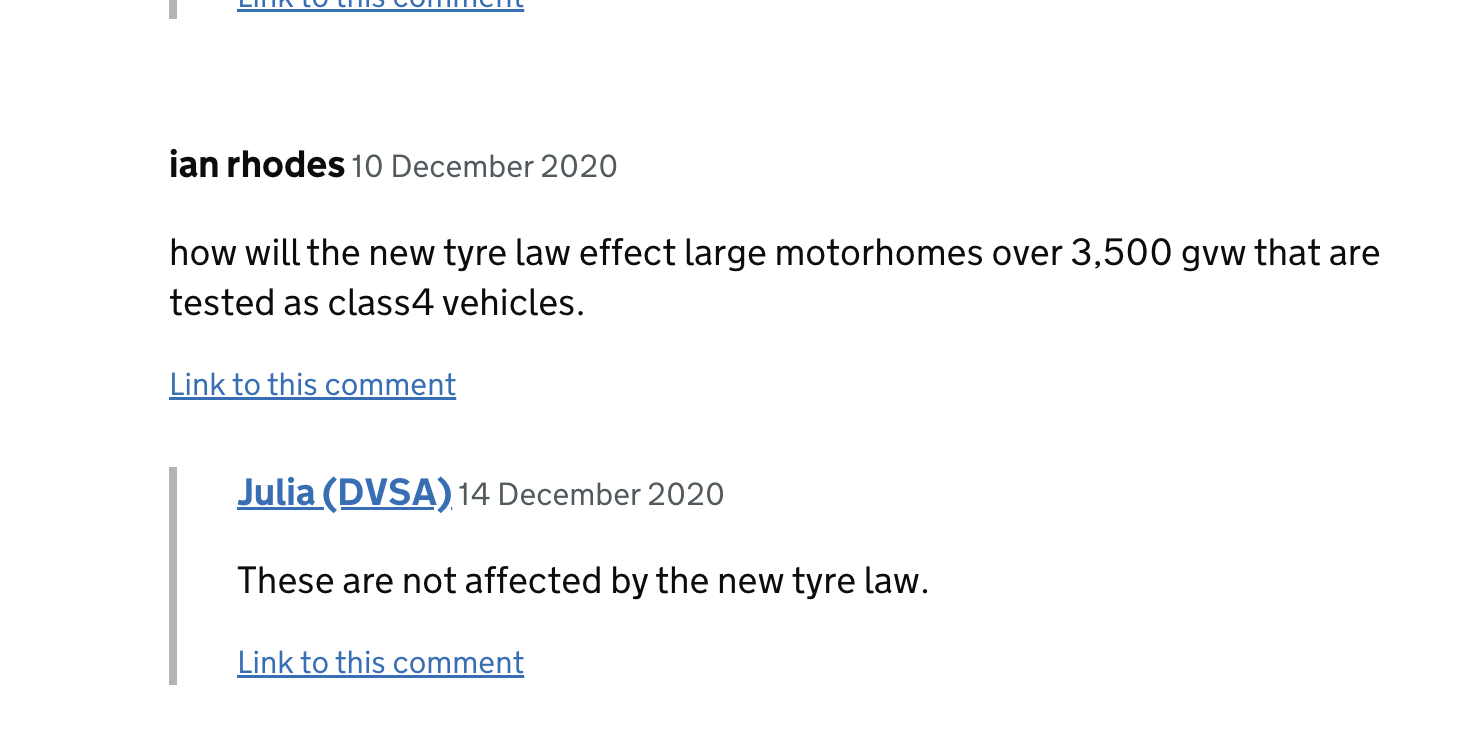

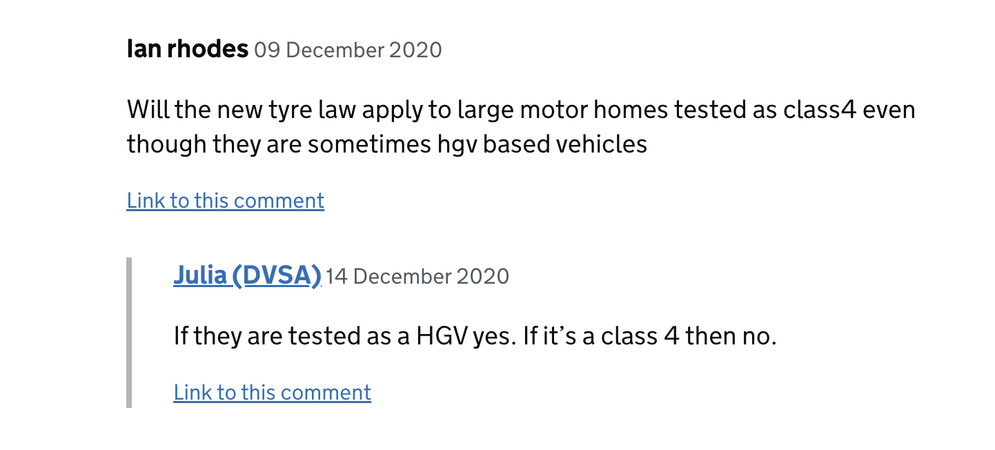

legislation doesnt affect normal motorhomes, from the inspection manual "The check of tyre age applies to all vehicles with more than 8 passenger seats, other than vehicles of historical interest"
I had a 6 year old tyre go out of shape on our last trip, trying to find a tyre place that kept anything in stock of the correct size was not that easy so had to have the only tyres that ATS had on the shelf
Agreed, below are a couple of screen shots from DVSA Q&A page,
