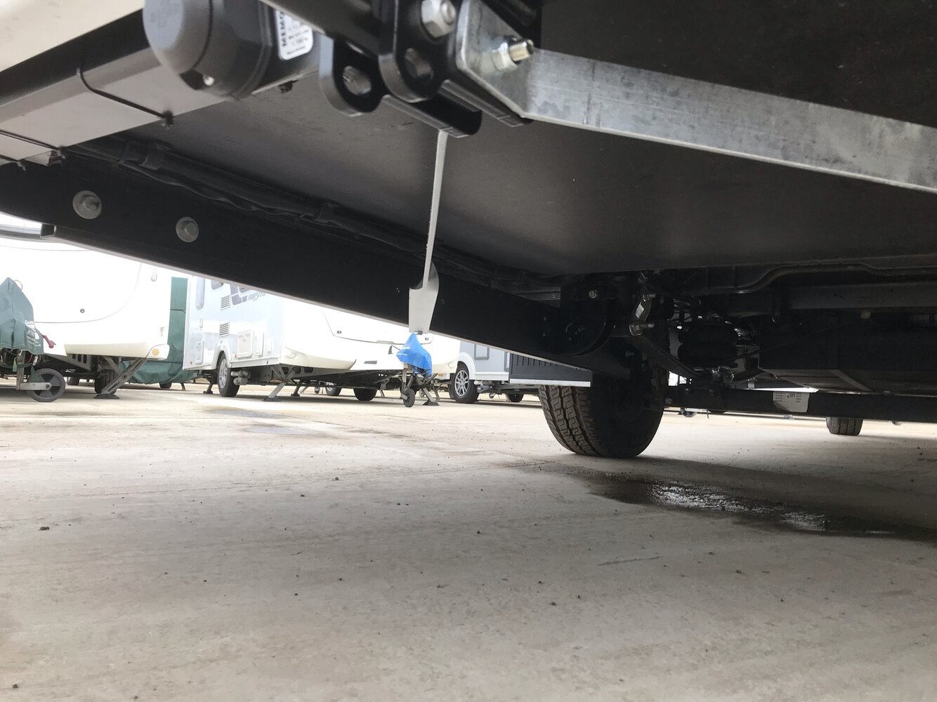

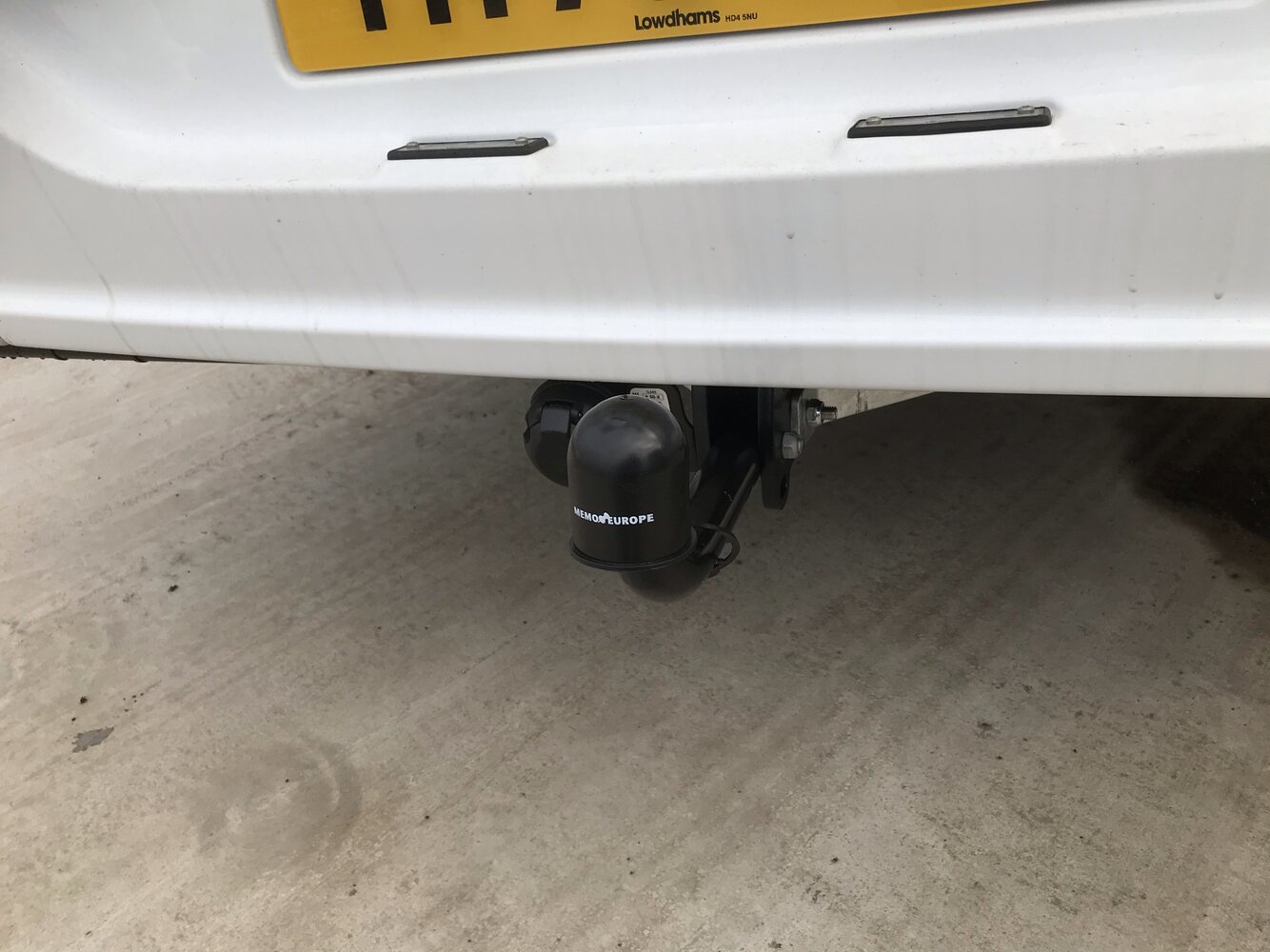

Dropped the van T68 at SAp, Doncaster Wednesday morning to have rear air suspension and tow bar fitted.
Done and dusted by Thursday lunch.
Tow bracket even with the extra racing looks very neat and professional.
35 mile trip back, even at 2 bar, van still loaded, you could feel the difference when passing vehicles
at 60+ or being passed, more stable less white knuckles. Been suggested I try 2.5, will try that but first will adjust tyre pressure as has bad under steer which could be caused by o ever inflated tyres.
