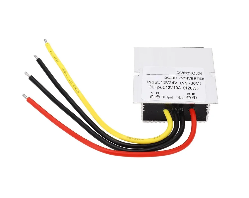

solar is adding to the leisure battery that creates an over voltage
That is wrong, solar goes to a controller, then to the battery, there will always be a variable voltage on the battery, Voltage can be anything from 11.9 volts when discharged to 14.8 volts when fully charged, Air Pumps are not normally fussy, and if somehow, he is correct, then all you would have needed, was a DC regulated power converter, which are only a couple of quid. If anyone is installing any 12v Electrical equipment, that needs a precise 12v DC, it is best to use one of these, see picture:
View attachment 1003859think that .it be pushing it 10amp for a compressor , especially if starting under load

it appears that there can be an issue on some motorhomes when the solar is adding to the leisure battery that creates an over voltage (i am not an expert in those matters, but Martin probably is, so i took him at his word)

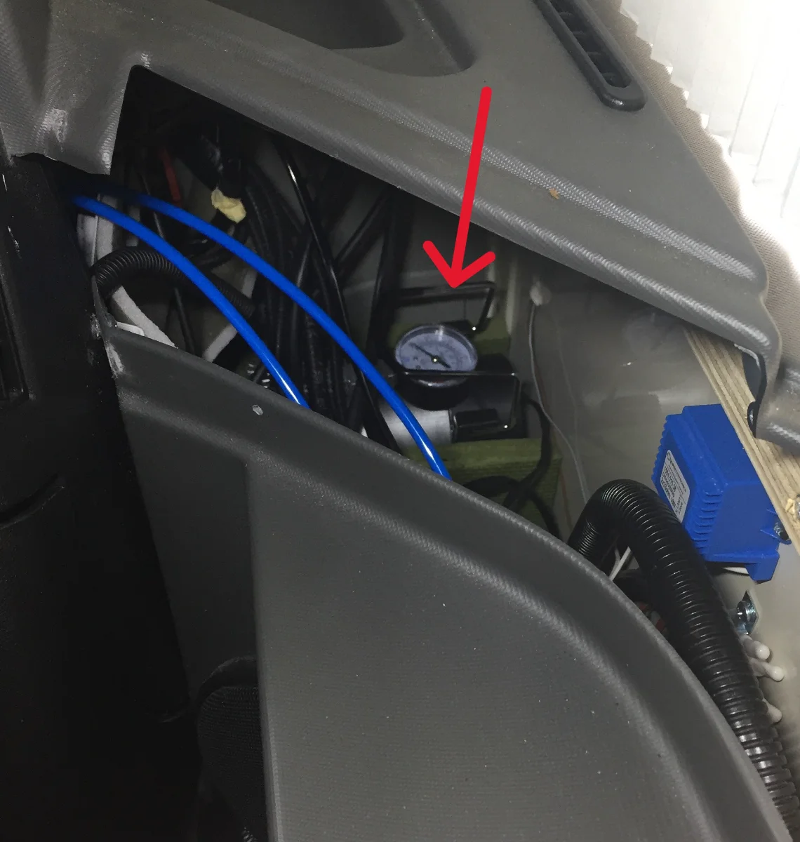

It is very easy to do yourself, and you can put the pump anywhere you want (I put mine in the space above the wheel arch)Aclass van, just make sure the pump can go up to 150PSI , I used a cheap £300 Kit from ebay. p.s. if you need help , just message.
