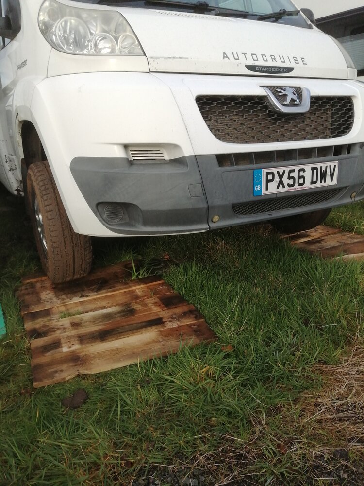

Bit off piste, but still jack-related as it were. Absolutely wouldn't be without mine, but recently found yet another reason to like them.
I went to get van from storage to find the front wheels spinning when I tried to set off. There was a slight rise in the grassy pitch I hadn't even noticed in summer. Several attempts to rock it back and forth just deepened the ruts. Enter the jacks! Raised the front well clear of the ground, put pallet planks underneath and for about a yard in front, jobs a good un. Took about 10 minutes...
