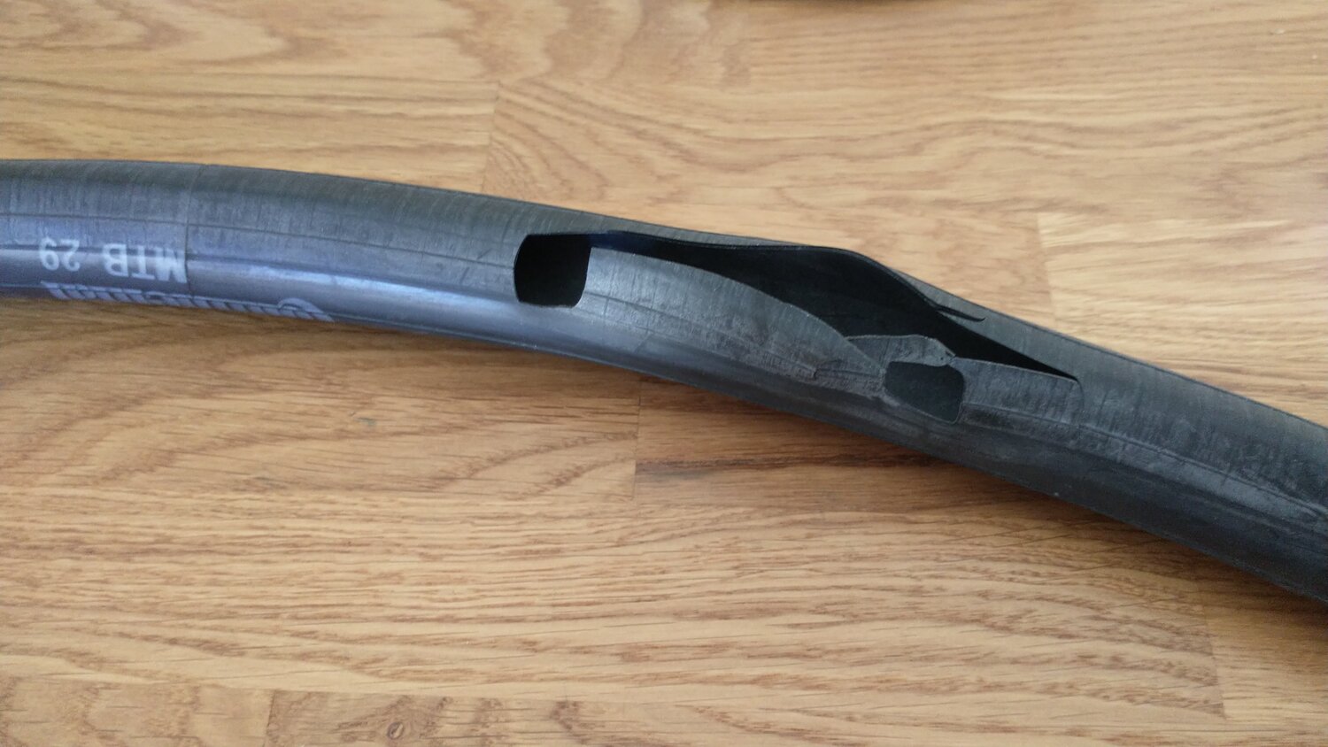

Hi, Apologies for jumping back on this thread with another puncture question - I wasn't sure whether to start a new thread or not, so I hope you don't mind. 🤞
I decided to swap my Slime inner tubes for regular tubes and a pair of Zefal tyre liners (blue) on my Cube Kathmandu hybrid e-bike.
All went fine and I've been out a couple of times (50 miles approx) since I did the swap on Wednesday. This morning though, I went to get the bike out for a ride and the inner tube had blown-out. It was a new Continental tube on Wednesday. The tube has not blown-out at the location where the tyre liner ends which I did wonder about.
When I changed the tubes I was careful to check that the inner tube hadn't caught on the rim, but perhaps I missed something? I do check the tyre pressure before each ride (50 psi). The tyres are Schwalbe Marathon e-Plus 29".
Are there any suggestions please on what could have caused this - I'm of course thankful that it didn't blow-out when I was riding it?

Wow. 50psi is high. I’m big, and running 25-30psi. Maybe the high pressure had something to do with it??
Interesting that you mention the start and finish of the liner, as that is know to cause problems.
Slime inner tubes do feel thicker, and possibly higher quality rubber.

Hi LA! Thanks for your reply! Tbh, I did wonder if that was too high, but the pressure was recommended by a chap in the bike shop.
I'll drop the pressure down then and see how I get on! 🚴‍♀️

It looks as though you've had a blowout due to the high pressure.

I wonder whether March Hare is running 2.1s or 2.25s but 50 psi is within normal range for the standard version of these tyres. Running at 20-30 psi is likely to cause snakebite punctures for these tyres isn't it?
Thanks for your replies!
Sorry, I should have given more info about the tyres in my original post!
I've just taken a photo of the side wall - the tyres are Schwalbe Marathon e-Plus tyres.
The sidewall has the PSI as 45-70 PSI (3-5 BAR)
