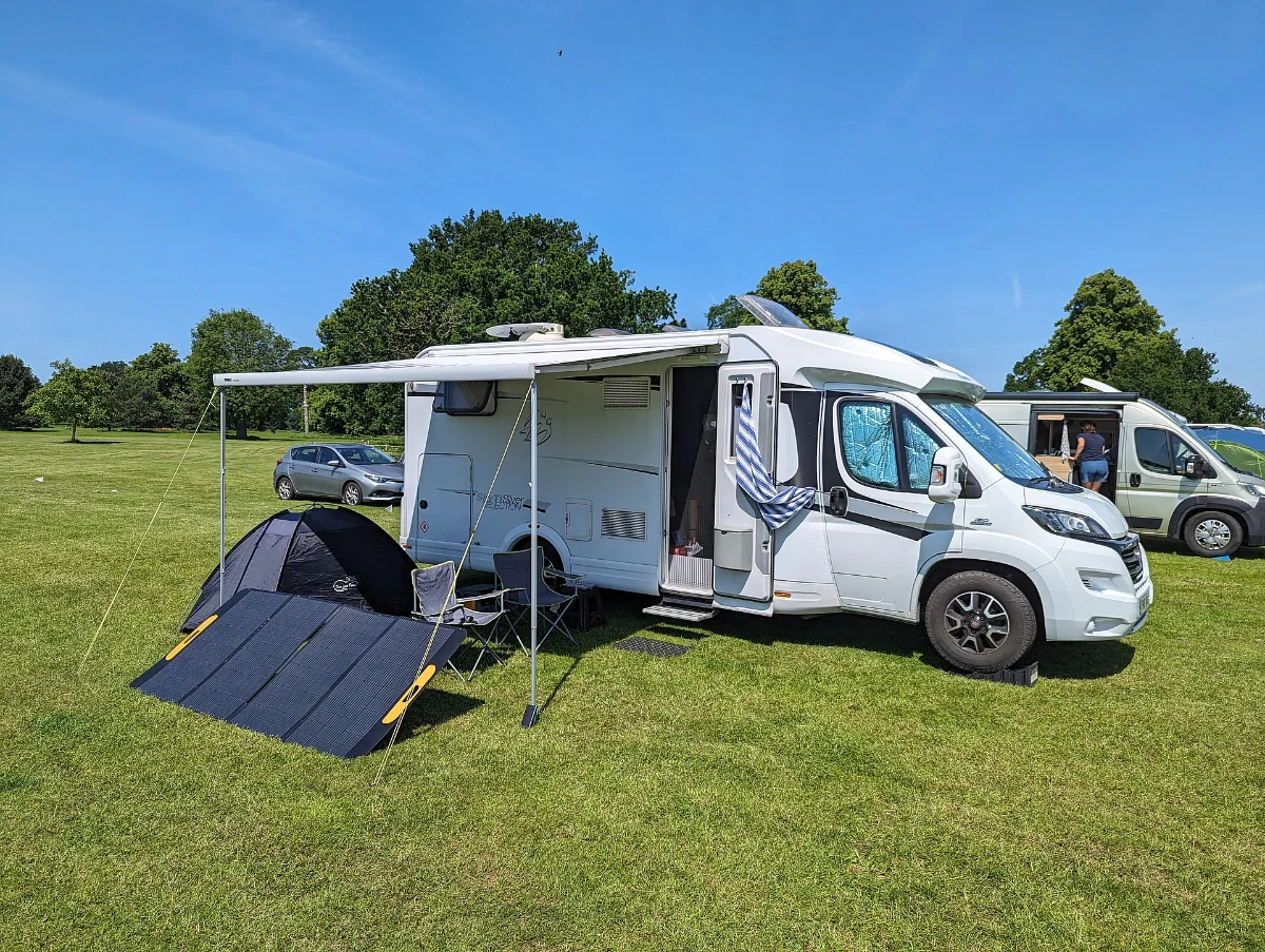

We have a VTOMAN Flashspeed 1500 power station with a 400W solar panel. It's like having 6 amp EHU when we're off grid. We're gadget heavy so it means we can stream TV and use laptop and devices as well as cook with our Remoska. I took this route rather than going with a lithium leisure battery setup bacause out leisure battery is under the passenger seat along with the charger so there's not a lot of room for a lithium setup as many lithium batteries are simply too big / tall. Really happy with the VTOMAN kit. Panel is superb. Generates over 350W of power in full sunlight. We do quite a lot of off-grid sports and aviation events so this has been a godsend. It fits in a gap under the sofa and I've made up a short hook up cable that drops down in to the service hatch so I don't need to put the unit outside, just the panel. We can run our laptops all weekend as well as charging up cameras etc. Keeps the leisure battery topped up too. On a sunny day the panel generates more power than the van uses! They are also useful at home too. The VTOMAN can be used as a redundant power suppy and it's brilliant for running electrical kit and powering tools outdoors. I'm a convert.

The power station weighs 19kg. The 400W panel weighs 17kg so it's quite a heavy setup but when we're off grid for the weekend it tends to be a single location so we don't take our motorbike or mountain bikes so we're OK on weight.

I've not used the solar panel to charge the leisure battery. We use the power station as we would use a hook up so we have power to all the sockets in the van. We just have to bear in mind that we have about 6 amps to play with but we don't use many high power devices. This way, it also charges the leisure battery. The battery charger only draws about 100W so negligible and on a sunny day, way less than the solar panel puts in which can be up to 350W. The solar panel cna be used to charge the power station at the same time the power station is being used to power the van.
I haven't used the 12v charger whilst driving. I either make sure the pack is fully charged before heading out or I use solar / EHU when pitched up.
