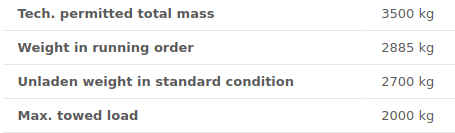

The only manufacturer I know that quotes unladen weight is Carthago they quote both unladen and MIRO they started doing it 2 or 3 three years ago. Probably to give the impression of more payload.
This is from one of their small CompacLine vans.
im sure theres an unladen weight on my coc from burstner
