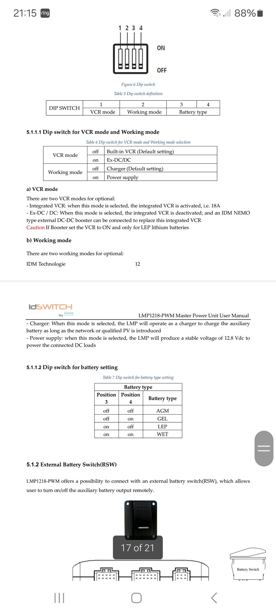

hi thanks again ,,is this info in the handbook ,? not sure what a vcr is ,,not a video betamax is it 🤣
hi i just checked through the hand book ,,cant see anything about changing profiles ,,

hi sorry to trouble you again ,,could you tell me what a dip switch is ,,and how do i access it? there is nothing i can see about how it works ,,in the download ,,

Item 16 on page 8, shows location. Page 13 and 14 shows the settings for battery type..
By selecting the dip switch options the built in controller you are changing the charging profile for the different battery types.
