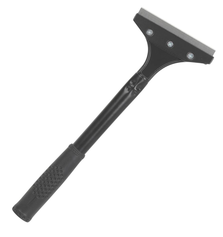

Warm it with a hairdryer and use one of these........ gently!
