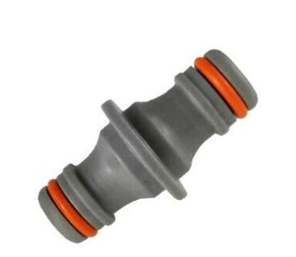

👋 Hi Guys - will rarely visit campsites and wondering about how to fill water tank - have a some ideas but don’t know how practical they are in real life.
Q1: Is the Rheinland water filler cap as useful as it looks to be?
Is the Hozelock type connector universal throughout Europe?
(I’m thinking friendly householders would let me use their garden hose more happily if I didn’t have to take their Hozelock end off - and old Hozelocks often disintegrate when messed with)

On a pitch, I’m exclusively using a flexible 20L bucket with a portable whale pump. Luckily my Motorhome has the right 12v outlet on the side near the fresh water inlet.
At home I use the hozelock pass through connector, like your pic, that PaulandChrissy make (& sell here) with their 3D printing skills.

Plenty of Hozelock connectors about but the most common fitting we found in France Germany Belgium and Italy etc is the 3/4” screw thread on the tap (I’ll have to double check size)
I use an adaptor similar to this with different screw sizes.

We've always used a simple length of hose with Hozelock type connections and filled by inserting the hose into our vehicle filler. We carry an inline tap as rb62 says above also the adaptor threaded fitting to fit the unusual size tap threads. On the rare occasions that we cannot access the tap with the hose we also carry a clean plastic watering can.
On the vehicle that we are having converted at present there will be a push on connector which will connect directly to a hose (with Hozelock type fitting) but I have insisted on having a water filler on the side to allow gravity filling for the occasions that we may need it.
10m supposedly food grade blue hose and some hose/tap connectors. I doubt we treat/store the hose consistently with ‘food grade’ though. :giggler:

Both sizes of hose connectors ared in Europel, but this I've used occasionally & it's been a godsend!
This is all you need, plus a 20m length of hose with a female hozelock coupler on one end. A jubilee clip is useful to hold the rubber one onto taps (eg in public WC). The tie wraps are used to hold open all those pesky auto switch off buttons.
