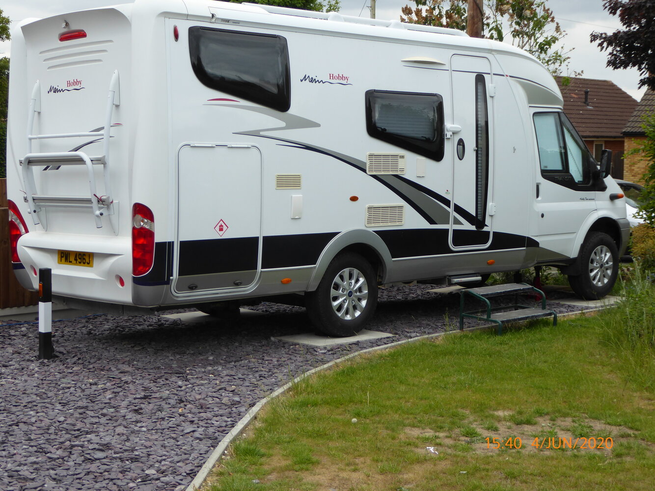

Going to be reclaiming part of the front lawn for a new parking spot for a 3.5t motorhome.
Just looking for thought's on which method people would recommend.
The options I am considering are,
1. Concrete slab with gravel surround
2. Concrete strips to drive onto surrounded by gravel
3. Gravel
Drainage is not a problem for a concrete slab.
Hi our soloution was to mark out an area with edging. concrete in four heavy duty slabs in the exact position of the wheels, and then cover the area around with slate chipping. This meets with council approval to allow drainage. A concrete slab of that size would not meet drainage regs. Plus the slate looks nicer than concrete.
Hi our soloution was to mark out an area with edging. concrete in four heavy duty slabs in the exact position of the wheels, and then cover the area around with slate chipping. This meets with council approval to allow drainage. A concrete slab of that size would not meet drainage regs. Plus the slate looks nicer than concrete.View attachment 418540
Have you got details on the slabs as this looks ideal for me, thanks
Sorry for late reply the slabs are heavy duty highways dept spec, and were supplied by a local groundworks company. They probably came originally from a main stream builders merchants.
