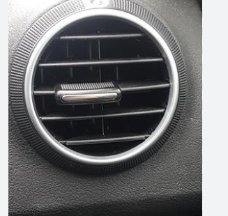

My wife uses 1 or more of the following :giggle:
