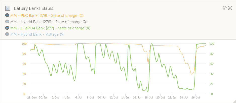

I like a graph or two :)
This one taken from my motorhome this month illustrates nicely your comment "There is no better way of using (not using) a lead acid battery than in parallel with a LiFePo4 battery as the lead remains virtually unused"
The green line is the Lithium SOC; the orange line is the Lead SOC. The Lead only really joins the party when the Lithium is getting very low (so in terms of service lifecycles, the Lithium will be using much more of its way greater cycles than the Lead is.
(note, when I say "joins the party", Lead and Lithium are both present and available at all times, but the Lithium is the one doing the work, the Lead is just skiving in the background).
That is a great illustration of what should be an easy concept to understand but one which many are somewhat averse to. Perhaps it is as you say, a lack of imagination. 🤷‍♂️
Ian
