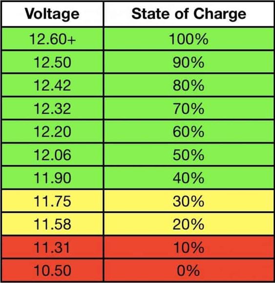

It really depends how accurate your dispaly is. My Burstner dispaly reads 0.2 below the actual voltage of the battery. I know this as I check the battery level with a multimeter. Might be worth getting one. You are OK down to 50% of battery capacity which is generally about 12 volts. (varies according to battery type. You can look up some charts on the internet but this is an example.
Don't forget - display will read lower when in use. You can only tell the true state of the battery after an hour of no use. When solar is charging it will read higher than actual. Telling the actual state of the battery at a single point in time is quite difficult. 4am is a good time to check it (assuming you haven't used it the the prior hours or 2)

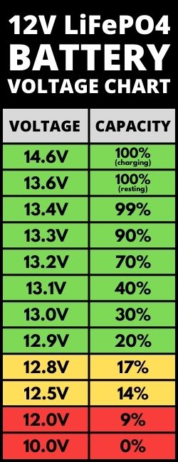

The reason I ask is that I was sent a similar guide to capacity when I installed my batteries but with quite different numbers.
12.6 volts on that indicates 100% but on my guide 25.2 volts is a little over 14%.
Just to clarify a point from earlier in the thread, the Phantom app is definitely the starter battery, I made a similar assumption to my cost! If you have Truma iNet that displays leisure battery either on bluetooth or through the text comms.
VXman's chart is for a lead-acid battery. Your chart is for a lithium (LiFePO4) battery. The corresponding chart for a 12V LiFePO4 battery has voltages exactly half of your 24V chart.
Many thanks, I had no idea the voltages would be that different for the different types.
Mark
