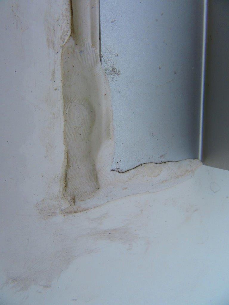

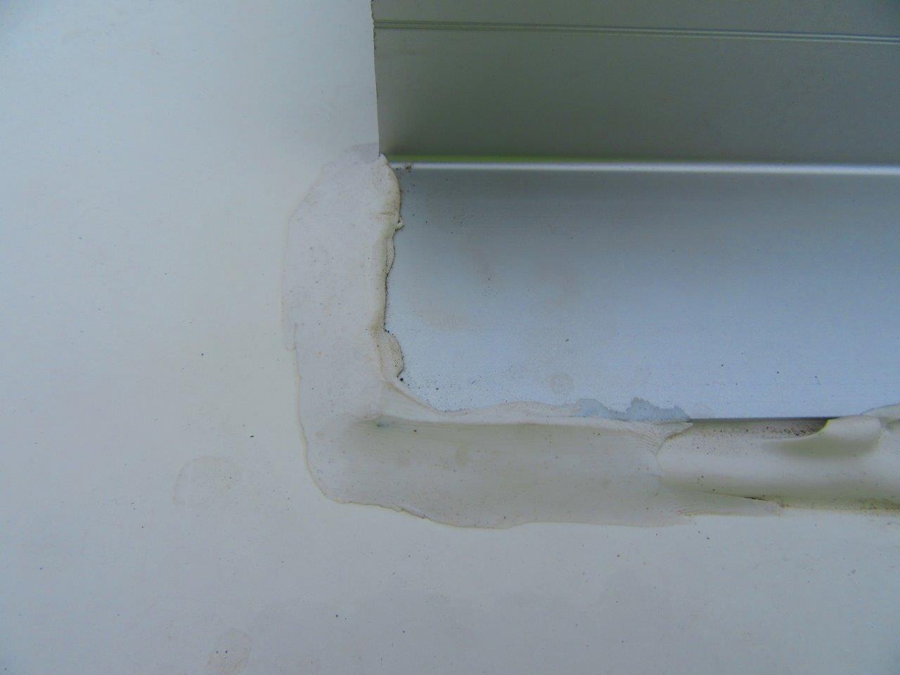

Why not put a copy of this on his mobile website.View attachment 809110View attachment 809111View attachment 809112View attachment 809113View attachment 809114View attachment 809116View attachment 809121View attachment 809122View attachment 809123View attachment 809109
Have you seen worse fitting than this of a solar panel?- Our understanding is the warranty company paid over £1,700 to Leisure Tech NE including 15 hours of labour. This was to remove the bolts from existing feet, cut cable at the end of exisiting conduit and joint to new panel leaving 2 joints on the roof. Thats it. Of course they estimated for a lot more work that wasn't undertaken. We have been discussing this with the warranty company for several weeks and finally they sought some redress from the company. But - we are now told that the workshop side of Leisure Tech NE Ltd has closed down and owner seems to be going back to mobile work. There is a lot more to this saga than this but I think the photos pretty much tell the tale.
Lessons learnt - even if you are going through a warranty then pay attention to the detail - Perhaps this would never have happened had it not been paid for by a warranty company, and paid before work was even completed.
Although we were sceptical of these insurance type warranties from dealers - actually it could have worked really well and the warranty company, TMO paid out.
Don't rely totally on recomendations and previous work. Get a written estimate or quote saying exactly what they are going to do. Applying trust with people leaves you feeling like a muppet when it goes wrong. Seems so simple afterwards.
We move on now and will sort out the mess ourselves. View attachment 809115

Got to agree with you that is reeaally shoddy work, companies that work to that standard need naming and shaming.View attachment 809110View attachment 809111View attachment 809112View attachment 809113View attachment 809114View attachment 809116View attachment 809121View attachment 809122View attachment 809123View attachment 809109

I have seen many far worse. Also seen quite a few on here that have lost solar panels which is even worse still.Reassuring that it seems we do have the worst fitting solar panel- no disputes about this so far?
On our coach built before the ambulance I stuck a flexible panel straight to the roof , worked fine , still on when we sold it and still working.There is an air gap. These are the NEW panels supplied by their supplier ?? to stop! people taking them off when they sell the van - as this reduces the amount they then sell- Integral feet apparently?
I am still waiting to see photos of a worse fitted panel.
Cable stuffed under panel - which was rubbing and had already marked the roof before I secured it
TWO joints on roof? not even opened the existing conduit to see there was a joint in there - just turning it through 90 degrees and cutting the cable. etc etc
Leaving exisistng feet on the roof and then saying they don't want to remove them in case they damage the roof etc etc
Still winning -![]()
