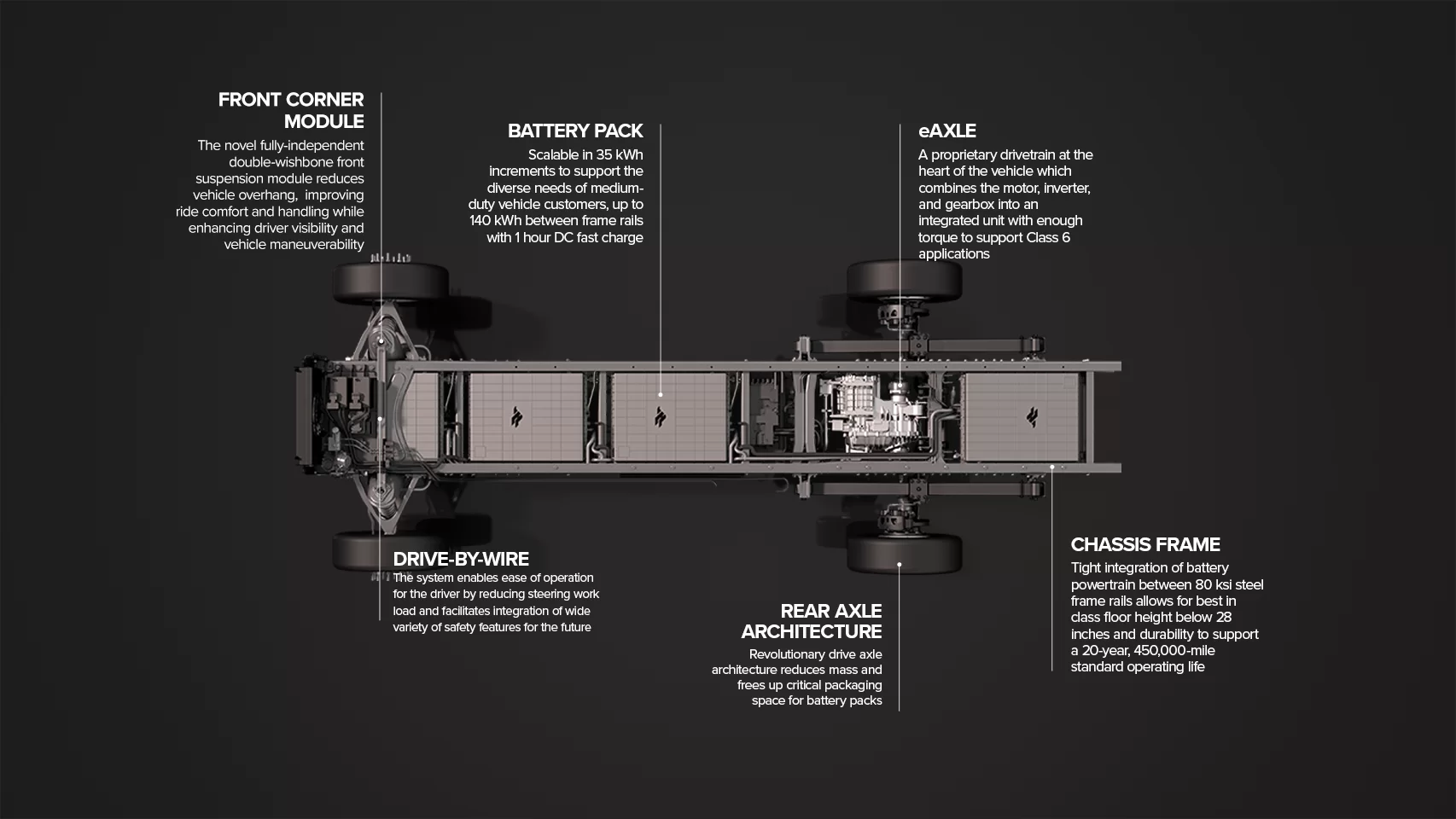

With the battery at the back I don't think there will be many MHomes built with garages on the back. They will have to put something at the front to balance it all out. Maybe that's where the water and waste will go.?
Not at the back. The are placed at various and configurable place along the chassis rails depending on capacity.
The water/waste can go on the outside of the chassis rails. Look at the space between the outside of the rails and the out edge of the wheels.
Also some stuff could be hung underneath the batteries.
I've just been and found that exact diagram on their website! If only I had caught up on the comments before looking onthe web.
They are quoting the smallest version of the chassis as rated for 16,000lbs (which in "American" is 8 tons or just under 7.5 metric tons). That would be a good sized motorhome in the UK.
Whoever designs a motorhome on this chassis will have a challenge designing water tanks etc to fit around all the equipment between the rails and avoid getting them too near the ground
