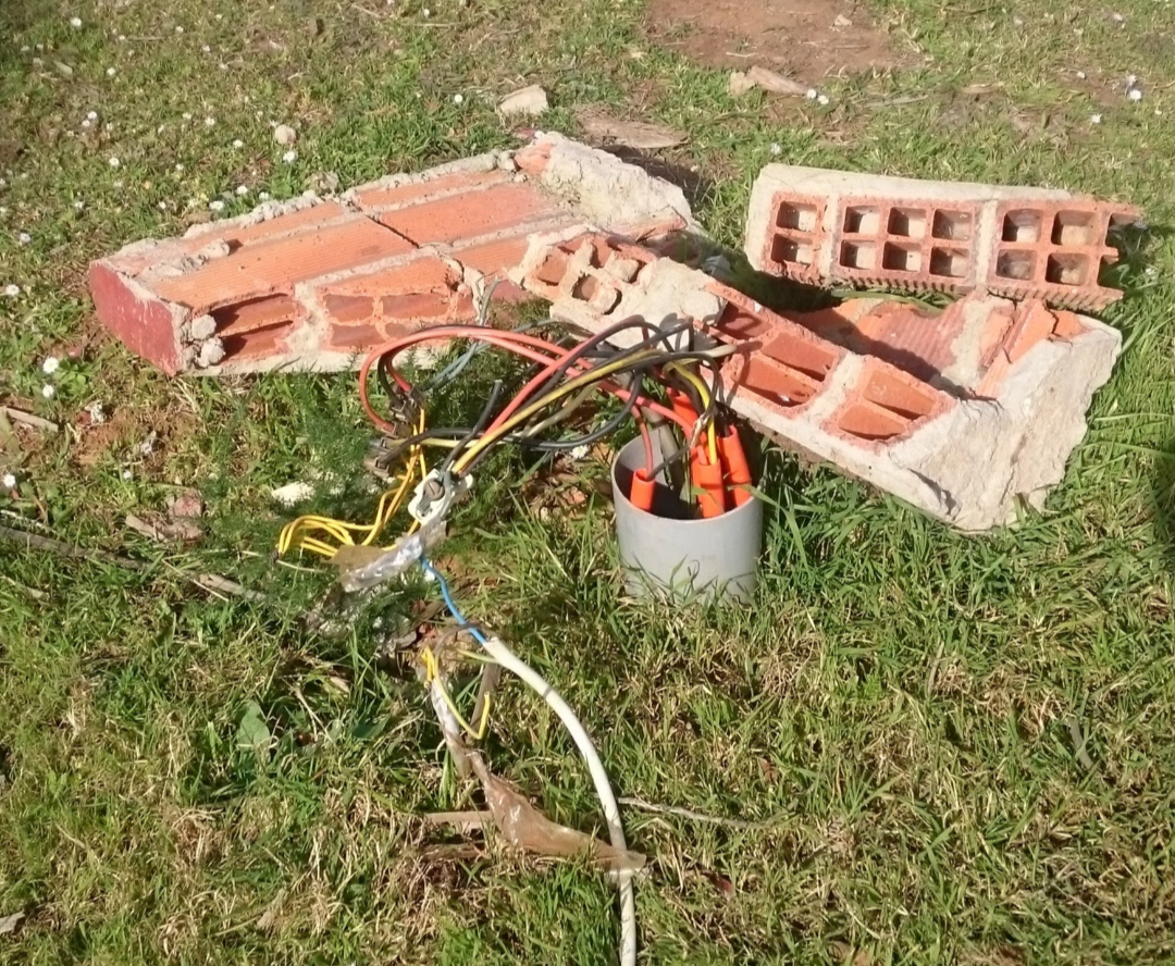

Thats assuming the hookup is fused or protected by an MCB.
Don't get many of those in Morocco.....
