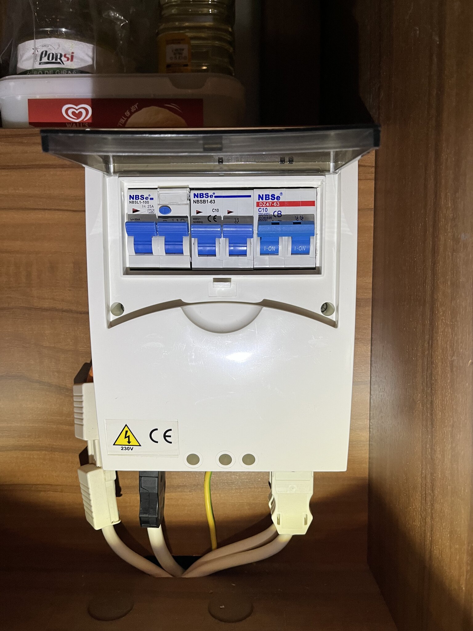

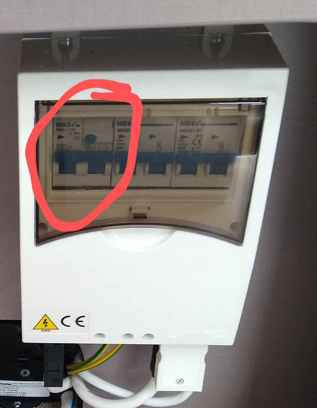

DIY, you don't need to do anything which is a little bonkers. But then DIY gas is fully permitted in vans too - which is scarier if you see some DIY installs!
But having one is no issue, and I'd recommend both RCD and dual pole breakers (as reversed polarity is fairly common abroad).
Bear in mind an RCD trips if "you" are carrying current to earth and thus stops you having a shock, not having one is madness really. Never trust your hookup connection to save you!
Should be part of the CU - but if hymer have their "own" then who knows!
I'd not want to say if its "law" or not, or if it only applies to UK made vans?
Edit: Something like the PO104 is excellent for purpose (I've used it on both vans I converted)

Ralph fitted one in Pug David. We had one in the previous shop bought Mizar too.
He says are you sure you haven't got one ?

Odd - (a) thats missing, and (b) that will allow you to draw 23A from the hookup - yet the cable and socket is rated to 16A only regardless of what the supply could give. So you could max the 23A through an unrestricted EHU post and overload cable, socket and get into a right mess.
There is a reason the one I posted above has 10+6!
