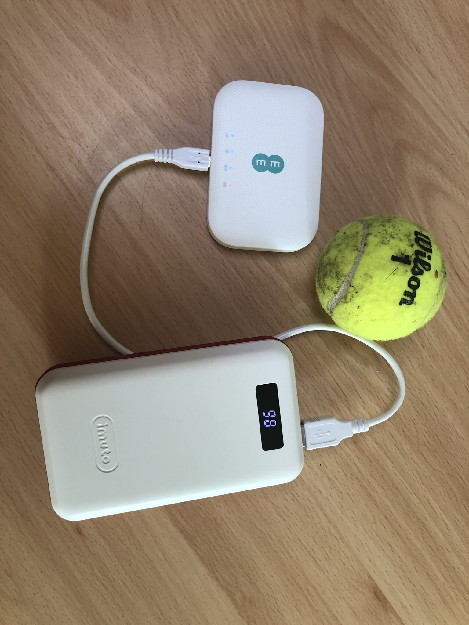

We use this mobile Router, USB powered. I normally use the shown power bank to supply both it and a camera for keeping an eye on the Dogs when we’re away from the Motorhome,
Tennis ball shown for size purposes!
Don’t know what happened to the picture, try again.
