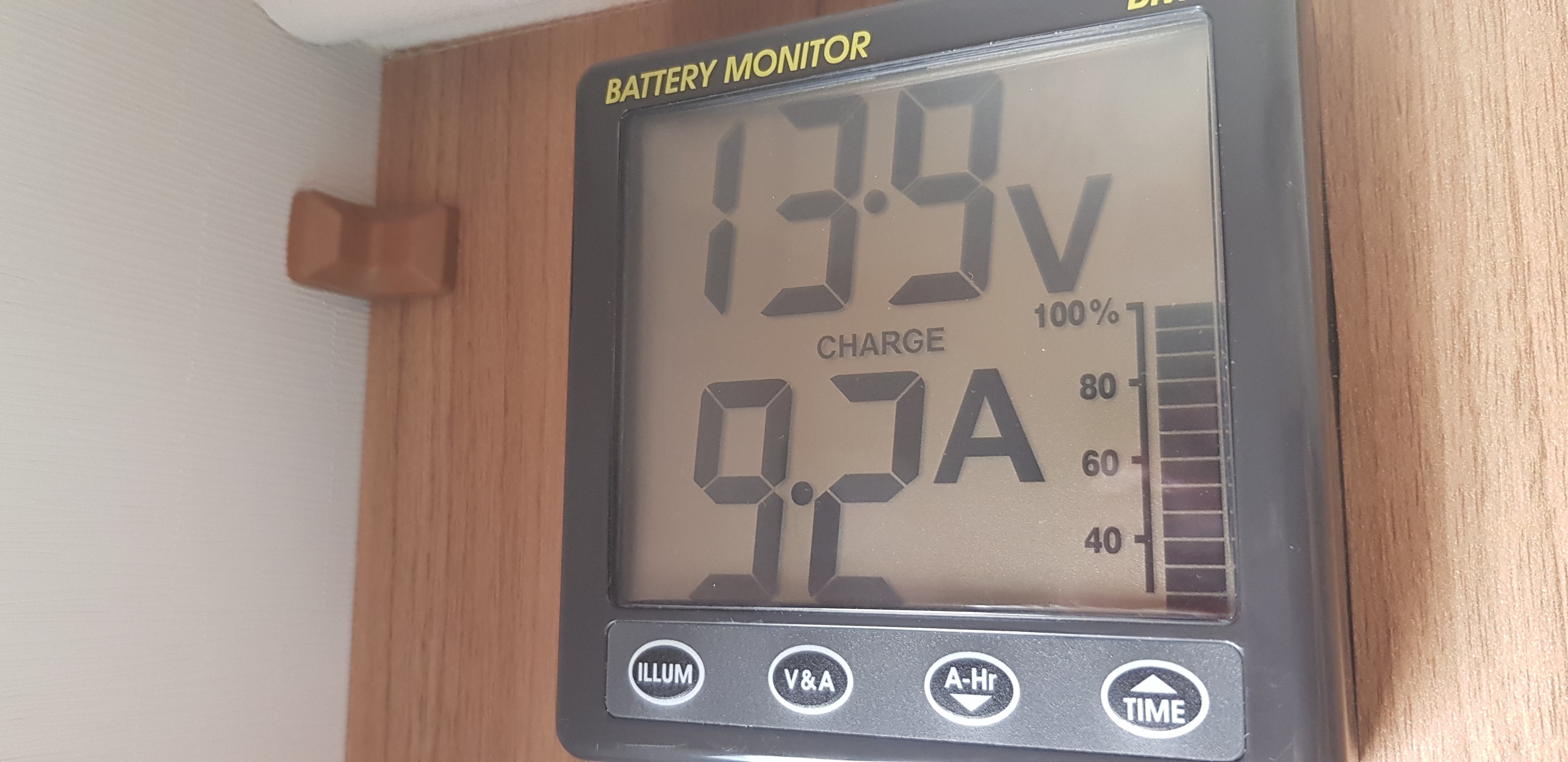

Yes I have been told that but was surprised it was 88%when I got home. I did check it twice.
Are we saying then the battery is ok when it’s - degrees in a galvanised compartment in the flooring,

Are you sure? That would be most unusual. Every motorhome I've ever seen has a method of charging the leisure battery from the alternator while the engine is running. If you've driven 200 miles that would account for it being up to 88% from 13%. For example there is often a relay, triggered by the alternator, that connects the leisure battery to the starter battery when the engine is running, so that the alternator can charge them both. When the engine stops, the relay disconnects them. It's called a split charge relay.
You can easily check this. When not being charged, a lead-acid battery voltage is between about 12.0V and 12.8V. When being charged, its voltage is forced up to over 13V, probably around 14.5V when being actively charged. So measure the battery voltage with the engine stopped, then turn the engine on and see if it goes up. Best to do this when it's dark to avoid the solar confusing matters.

When I bought the motorhome earlier this year I had the solar panels fitted, they told me I needed a new battery which I did but it wasn’t holding the charge, even when not using the motorhome. I ended up buying another battery and the same thing happened again. I then took the motorhome back to the company who fitted the solar panels and they found out the leisure battery was charging the engine battery eventually .
They disconnected that and told me it will just charge the leisure battery via solar panels. They were bemused as why it was wired up that way.

For the leisure battery to charge the starter battery it sounds like the split charge relay has failed.
A new relay will sort that out as solar in UK winter is pretty useless.

Do I do this with some sort of meter or get a battery meter fitted which has been mentioned in this thread

The OP's van is 1999 so no smart alternator or B2B, it will have a simple split charge.
OP, you have 2 choices really here
find and fix the alternator charging via a split charge relay. WHich basically just connect a relay when the ignition is on so both batteries are charged from your alternator (cheapest way) but could be a bit of a pain as someone else has disconnected"something" to stop the drain on your leisure battery to the vehicle battery
OR you fit a b2b something like below you can do that direct to the vehicle battery and lesiure battery terminals yourself and is easy enough.
there are higher amp more expensive ones depending on your usage.
