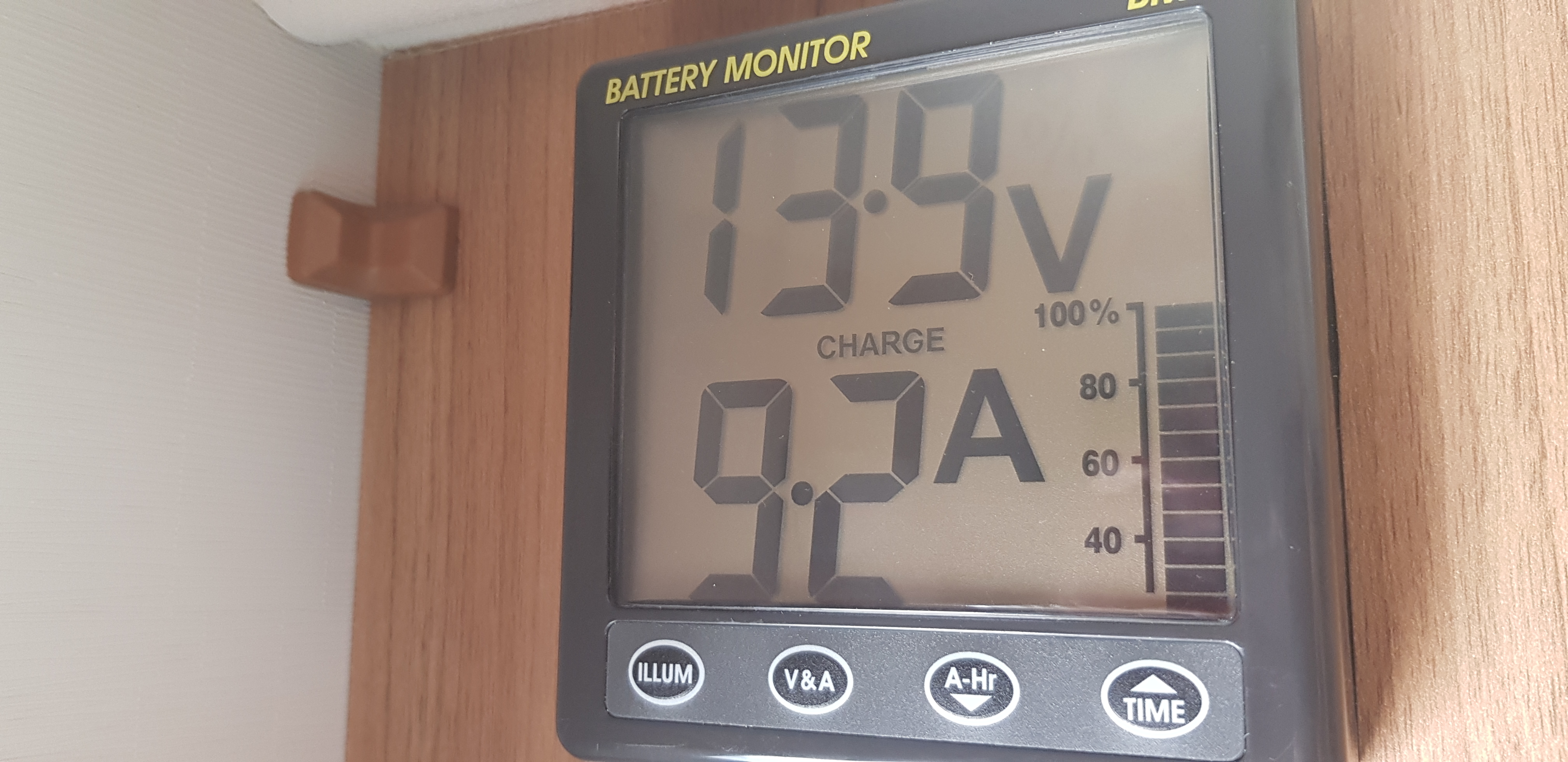

It was about -4 in Northumberland and the lights which are led started to flicker then the heater fan stopped. I checked the battery with the monitor and it was down to 13%.
When I got home it was back upto 88%

What kind of monitor are you using? Does it just read the voltage, or does it have a shunt which measures the amps into and out of the battery? How was it charged up from 13% to 88%? Was this from driving (how far?) or solar (was it sunny?).
The monitor just tells me the percentage it’s charged. I have the latest solar panels on it as they only need clear daylight. Yes I drove 200 miles home. The solar panel has a monitor in the cupboard which tells me the amps when charging.

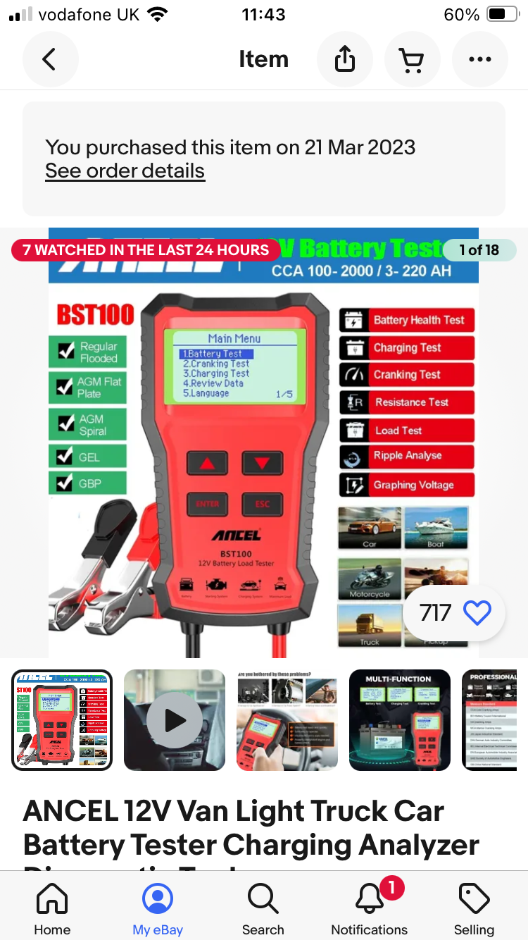

This is the monitor I have
That tester won’t tell you the real capacity remaining. It just guesstimates based on voltage reading. Cold to affect a lead acid battery it has to lower than -35C, probably in Siberia or Alaska. The mild cold will have a effect on battery, but not that severe. It is recoverable and will bounce back as it warms the plates under charging or discharging. If the reduced performance at only -2 it shows up, maybe your batteries tells you that they are near the end, and less capacity then before.
Flickering lights could be a intermittent loose connection as well, things do vibrate when driving. Needs more investigation.
Victron battery monitor, often referred to as smart shunt.
A ten quid Aldi multimeter will be more use than that.
It's primarily aimed at the starter battery.
A multimeter has many functions,, voltage, resistance, amps etc.
Can even check if a fuse is really good when it appears to be....that meter can't.
