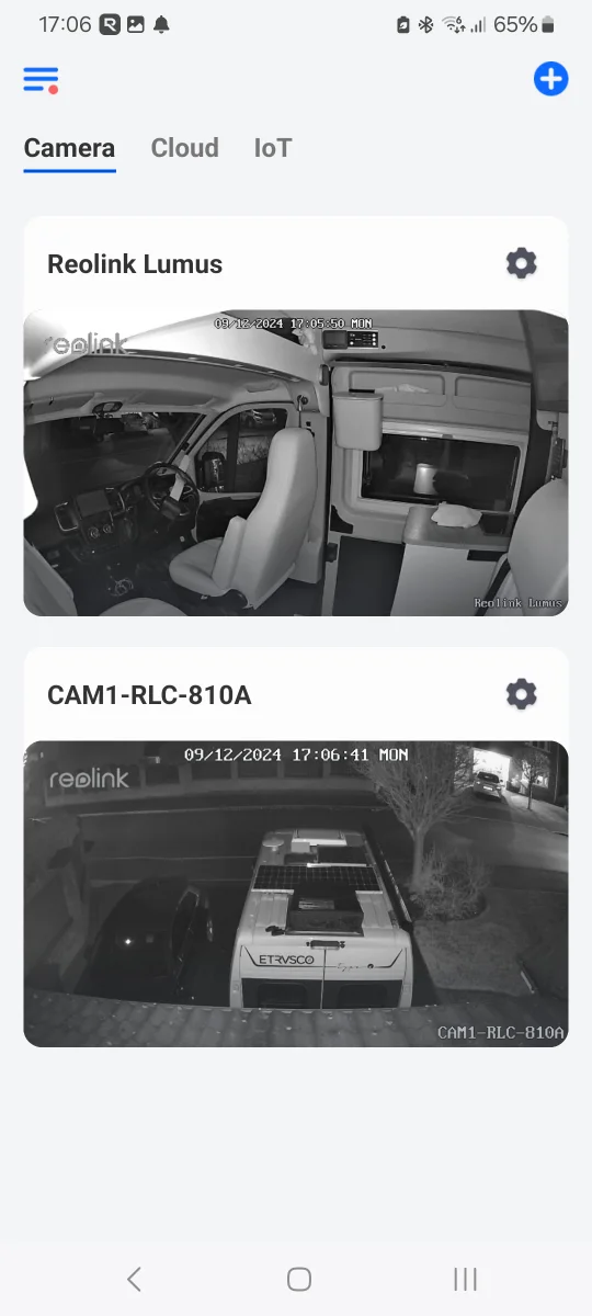

I have a fair amount of physical security in my van which hopefully will deter the bad guys. I have had externally visible deadlocks installed on all the doors, plus I use a steering lock and have a simple alarm which when armed is triggered by the interior lights coming on when a door is opened. I have also devised a system which when armed disables the auto shift lever meaning that the gearbox is locked in park even if the engine were to be started.
Despite all this I still feel a bit nervous about leaving the vehicle for any extended period and wanted a camera which I could access remotely and which would notify me of movement near to or inside the van. I have a Reolink outdoor security camera on our house which covers the driveway, and it allows a live view via the phone app even when away from the house and using mobile data, and will send a notification to the phone when it detects movement in specified areas. I have been quite happy about how that works so looked for a similar Reolink camera that I could put in or on the van.
I found the most recent version, though discontinued now, of a Reolink Lumus camera which seemed a bit more compact than their current offerings so got one of these off Amazon for £36. The earlier version which lacks 5G wifi capability and has a lower resolution camera is available even cheaper, for about £22 on eBay. I did think about installing it externally but wasn't convinced that it was durable enough for that or could be positioned for good coverage, and also didn't want to drill any more holes in the roof for the power wire, so decided to site it inside. I positioned it where it has a good view of the front half of the interior and with a good view out of the windscreen and sliding door window.
The earlier version of this camera runs off a USB power lead and comes with a USB 5V 1A mains adapter, so I was a bit disappointed to find the later version, though it also has a 5V 1A supply, has a hard wired mains adapter meaning that I couldn't just plug the power cable into a USB socket, so I will cut the cable and fit a USB plug onto the end. The camera connects to the internet via the wifi router in the van. The router either accesses the internet via the Starlink Mini mounted on the roof or by using mobile data via USB tethering to my spare smartphone which also runs Android Auto onto the Pioneer head unit.
I had originally expected to have to do some complicated remote access set up in order to see a security camera when away from the van, but the Reolink app magically connects the smartphone and camera so long as both have some sort of internet connection. As well as alerts and a live view the camera also records a video clip every time it is triggered by motion. It uses infra red lighting at night which gives a good quality black and white picture and can also turn on a bright light for full colour recording. The other useful feature is the ability to trigger a siren when nearby motion is detected.
The following phone screenshot show how both cameras can be monitored in the same Reolink app.
